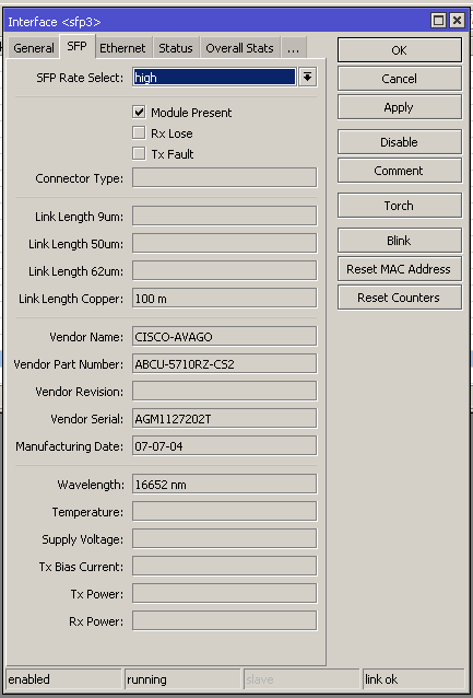

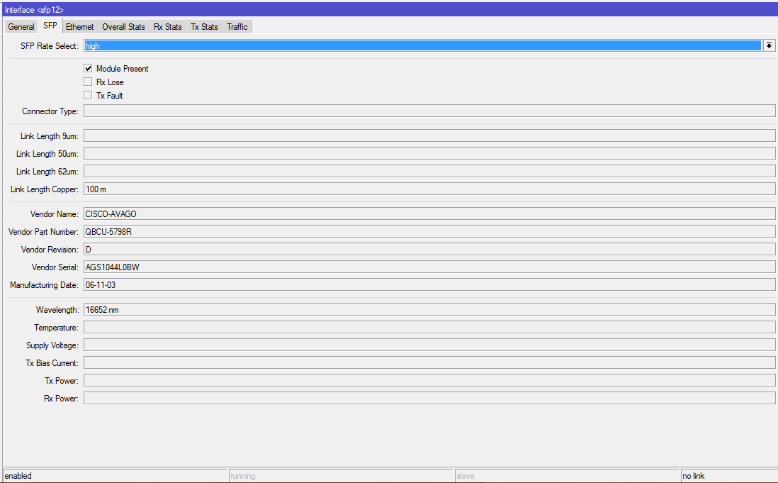

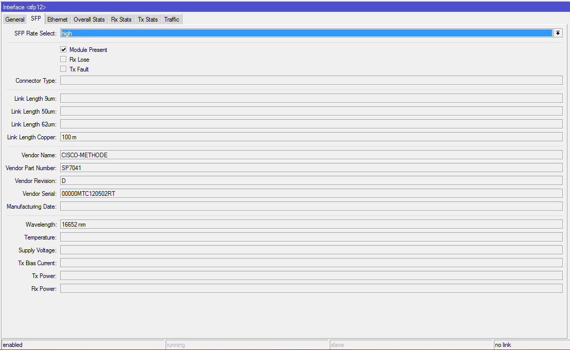

There is some variation is parts. The two GLC-T parts I tried didn’t work.
