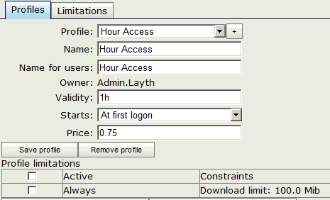

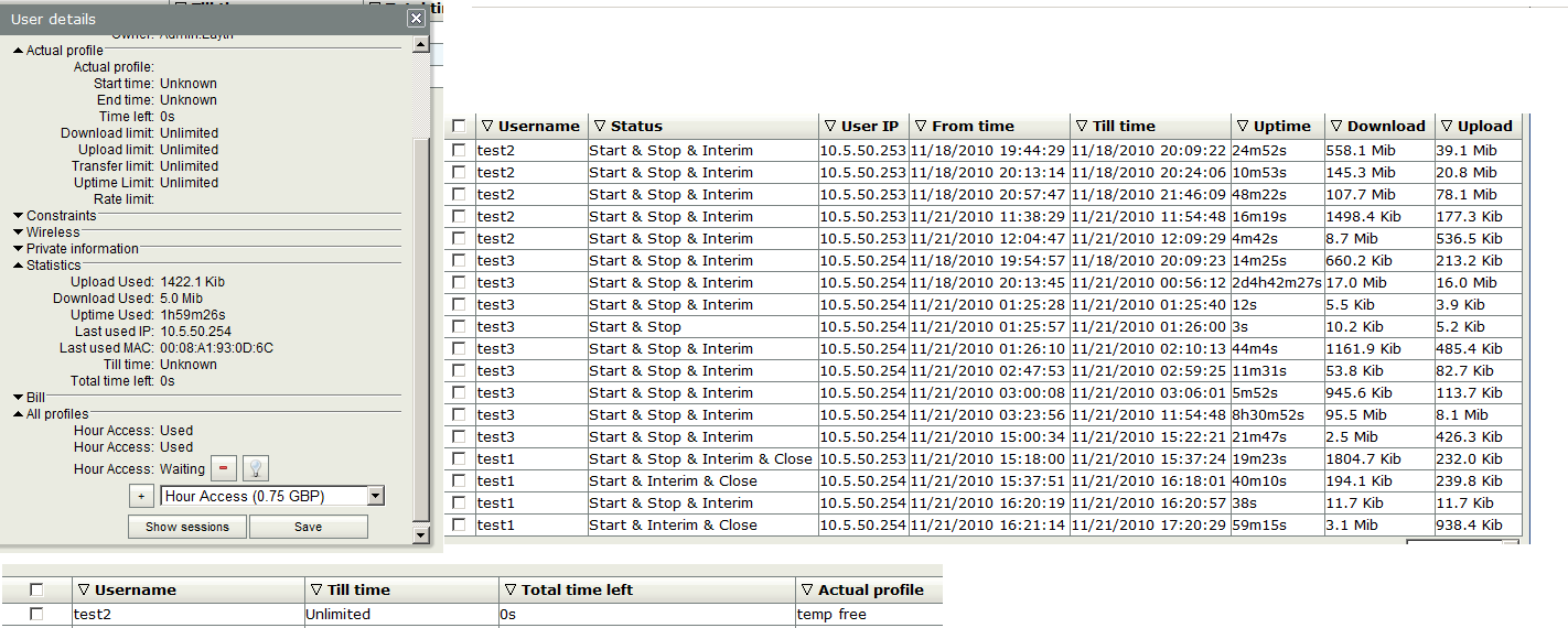

Here you go this should be what you need. Btw test1, is also on a 24 hour period.
The only attribute sent for that user is a one minute accounting interval (recommended is 600 or ten minutes). No WISPr-Session-Terminate-Time or anything like that. User ‘test1’ has no $(session-time-left) because there is no expiration sent by User Manager. Check your settings for user ‘test1’.
Its set, under limitations for 24 hours.
Everything you showed me in that user profile was set to ‘unlimited’ including ‘uptime-limit’.
But if that was the case, then why do the user cut out after 24 hours?
This is all that was sent to the router. No group, no time limit. Just an accounting interval of one minute. If the user is being disconnected, it is not due to the RADIUS server response.

Ok - so, what areas need to be set inorder to get this working correctly? Because I was under the impression that this was how it was meant to be setup.
It seems that may be how profiles was intended to work. I have V3.30 User Manager, and it has no “profile”. It uses Credits. I went to the wiki for User manager, and the page that described profiles (and their use) has been deleted. ??
http://wiki.mikrotik.com/wiki/User_Manager
Note the link to “profiles” is red. Now I don’t know what to tell you.
Ah ok. I thought I covered everything I could. I guess it’s just another bug in that case.
