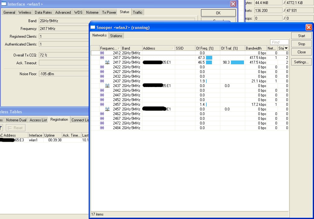

AP 2ghz-5mhz on 3 differnet channels when scanned

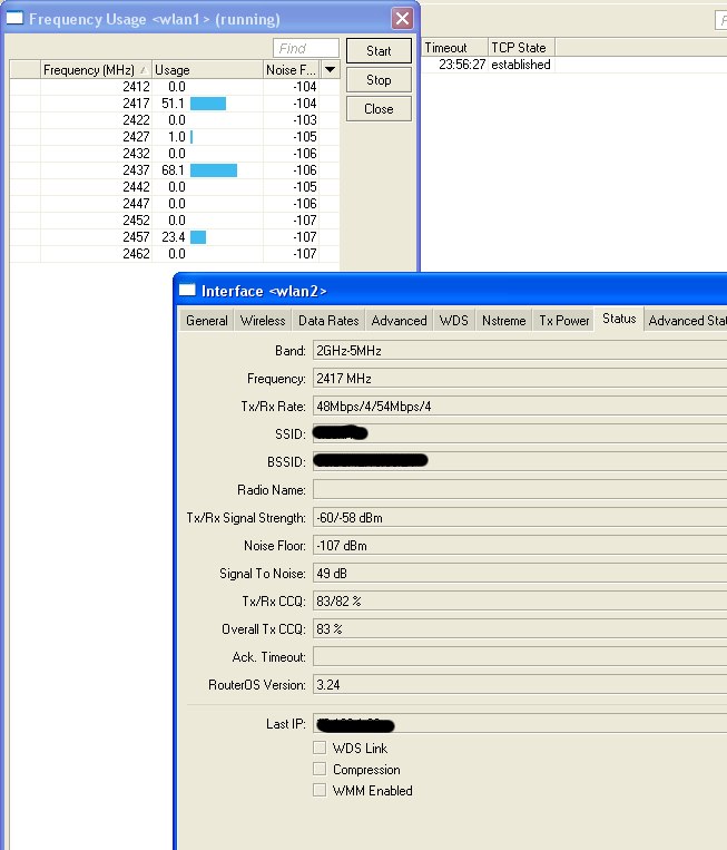

I recently set up a AP on a 5 mhz channel. When I do a scan or a freq. usage I see the AP on three channels 20 mhz apart. I also saw a similar pattern using 10 mhz channels.
Is this normal? I’m using a rb 153 with 2 R52Hs and ros 3.24 and the wireless-test package.

I’ve seen this before on some 900mhz stuff, but I think that was only on older v3 builds. never caused a problem though, seemed to just be a display error.
