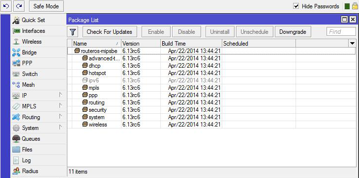

are you using regulat wireless package of wireless-fp package. If wireless-fp package then download the newer test release of the RouterOS v6.13rc7.
Would you please tell me how to check which wireless package I use?
I didn’t use any third packages by now.
Go to “system” "packages there see you what packages are installed.

Yes, I checked the packages, it’s wireless package of wireless-fp package. I’ll upgrade to v6.13rc7 to see if it’s fixed.

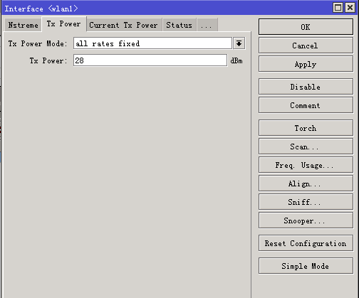

you mind me that I set ‘Tx Power’ to be ‘all rates fixed’ and 28dBm, would it be damage the radio cards or router board ?
