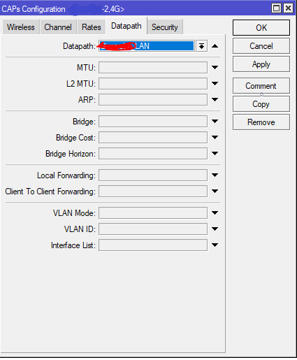

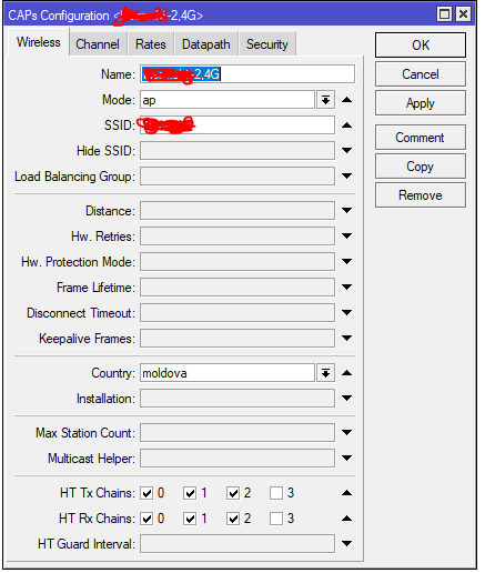

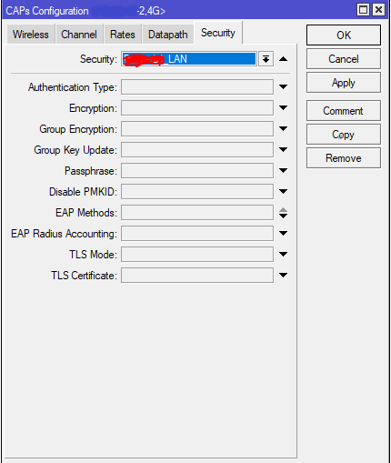

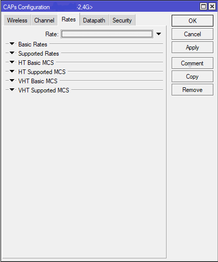

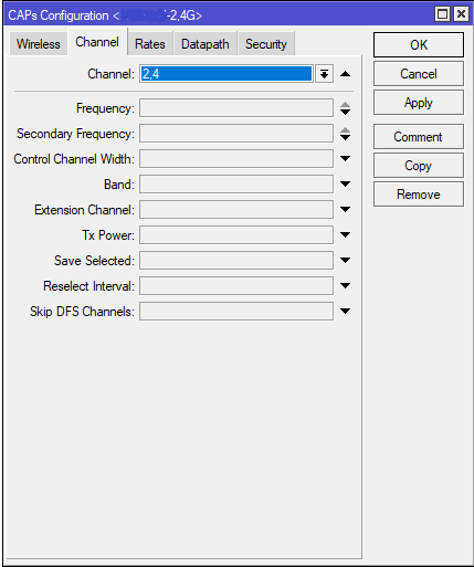

You would be better of if you show your config (of the caps manager):
/export hide-sensitive file=anynameyoulike
Besides, settings on the interfaces are overwritten by the CAPsMAN configuration.
As asked from @erlinden on previous post, make the export and post it on fourm,
you need less time than take useless screenshot.
Also, why post 2GHz config? It’s useless, as 2GHz is so full that it’s nearly guaranteed that you will get bad sped these days.
Post export with 5GHz config please. And are you testing 5GHz, are you sure?
