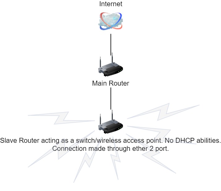

My above suggestions are based on assumptions that at least some configuration is sensible, i.e. WAN port is ether1. Now you’re saying WAN is ether2 … which makes cknfig even less sensible. I suggest you plot a simple chart with LAN setup, describe it slightly … then we can make configuration better. At the end speed might get to expected level, who knows?
Just to clarify things:
  • The connection between main router and slave router is wired?
  • what would be ideal function of slave router? Only switch/AP which extends LAN of main router or proper router/firewall which hides its own LAN/wireless from main router? (while thinking of the answer to this dilemma, don’t think about current config you have on slave router)

Answers(or the best i can give)
  1. The connection between main router and slave router is wired? Yes
  2. what would be ideal function of slave router? The ideal function of the slave router would be to only extend internet/lan routing from the first router via wifi and ethernet ports
I hope that makes sense.
