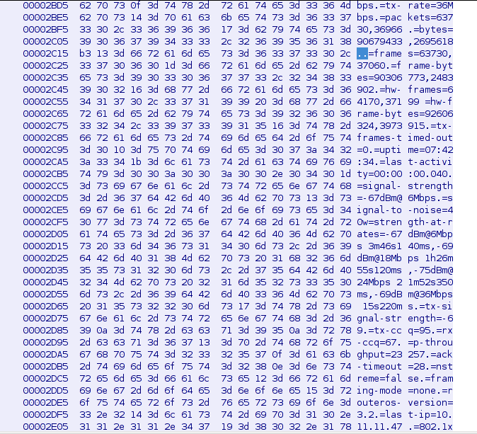

I checked incoming data from router with wireshark and found that sometimes when word length byte is first data byte of tcp packet then it consists of one more byte.
This is screenshot from wireshark:
Beginning of packet is at byte 2C15. There are two bytes but the length of following word is only second one. First byte is unknown to me and I very dislike it cause it kills my script.
I can present wireshark packet dump if needed.

First problem is harmless becouse i can detect it but second problem is worse becouse sometimes it creates good formed length number (which is totally incorrect and it makes word length bigger than 127 even though it’s smaller or equal than 127).
