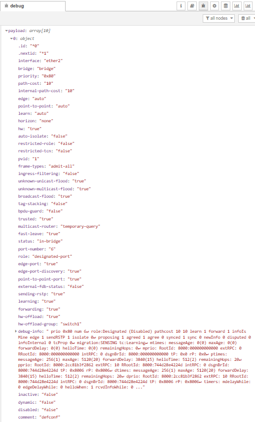

However trying to run these commands in the Mikrotik node in a Node-Red flow isn’t working.
The print command works just fine, returning an array object, but issuing either, enable or disable, just results in an error!
“ Error executing cmd["/interface/bridge/port/enable 6"]: {} “
I enabled SSH on the router, and using an SSH node, in Node-Red, the CLI commands, enable and disable, work just fine, but the print output is truncated and would be hard to parse.
Can anyone tell me why the API commands are failing?

When I run print on the bridge ports, using the API, I get a load of information that I don’t see when doing in the Winbox CLI which makes me think I am missing something fundamental.
I am assuming I should be able to look at all this in the Winbox CLI, but likely need to be asking for less perhaps? Even if the CLI printed 10 o0f these it wouldn’t be very useful after all.

Looks like the API output contains same amount of info as print debug shows.
