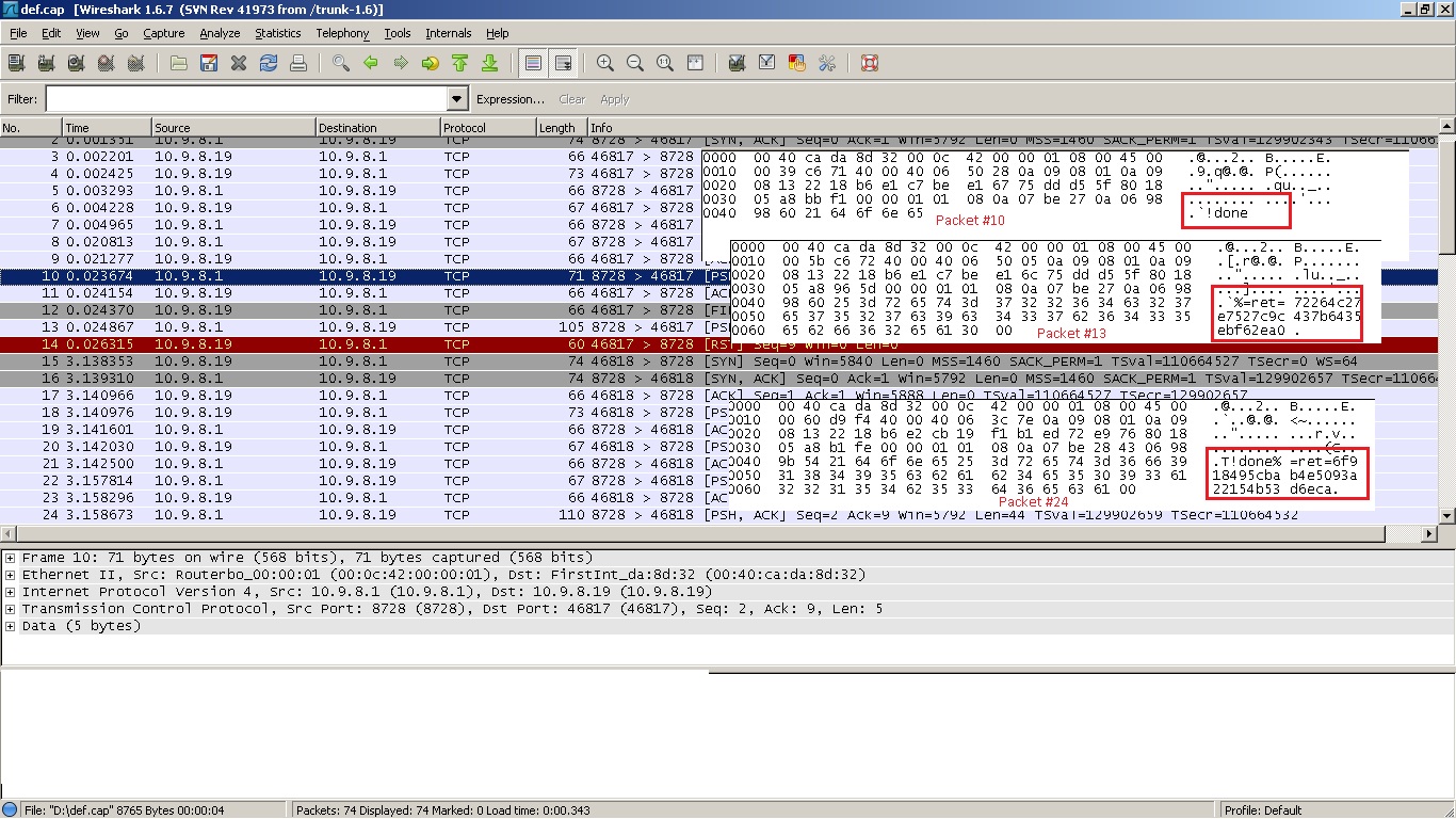

I think that dividing data into 2 packets is not caused by the size of data, but by the time of generatioin =ret=
in jpg there is failed attempt to login packets 1-14, and successfull login all packets below.
when i wait 10 ms after write, before read i tried to login 100 times, every was sussesfull.
…lot of ret…? i noticed this problem only on login

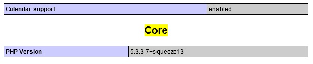

What PHP version are you having? PHP versions before PHP 5.3.4 are known to be somewhat quirky with fragmenting small and/or untimely socket data.
Note that even modern versions fragment large and/or excessively untimely data, and the PHP API class was not designed with that in mind. Try my implementation instead, which takes care of assembling all pieces (regardless of how PHP decides to fragment them). It requires PHP 5.3.0 at minimum though.
PHP Version 5.3.3-7+squeeze13
Assuming squeeze13 is your OS and version (a code name of a Debian release according to Wikipedia)… what do you mean with “5.3.3-7”? That you’ve tried with 5.3.3 and 5.3.7, with all releases between 5.3.3 and 5.3.7, or is this some kind of 5.3.3 snapshot (that happens to be 7th in some series)?
Regardless, my implementation should work with this setup. Try it. Please.
i’ve copied it from phpinfo() function
