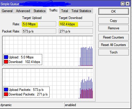

I am a C # programmer (newbie), I am developing a tool to aid in the visualization of some functions of Mikrotik (I use RB 1100).
Until now got everything ok, but I can not get the the traffic queue as the image.
Have you tried:
http://wiki.mikrotik.com/wiki/API
https://code.google.com/p/mikrotik4net/wiki/Tik4Net
Like a string variable receiving rx / tx the queue.
I do not know the correct syntax for running to get such value for SSH would be the “queue simple print rate where name = ”.
Using the “http://www.tamirgal.com/blog/page/SharpSSH.aspx” library, I get the result, but does not keep the session open, it would be logging in several times.
If anyone can help me, would greatly appreciate it. :smiley:
I’m from Brazil, sorry for bad english.
Thanks to everyone !.
RouterOS: 6:19
look at this:
http://wiki.mikrotik.com/wiki/API#Queries
