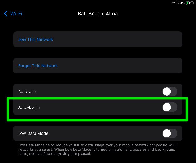

Just a quick update for you guys.
Randomly Apple disables this option, If this is turned off, CNA will not appear at all:
