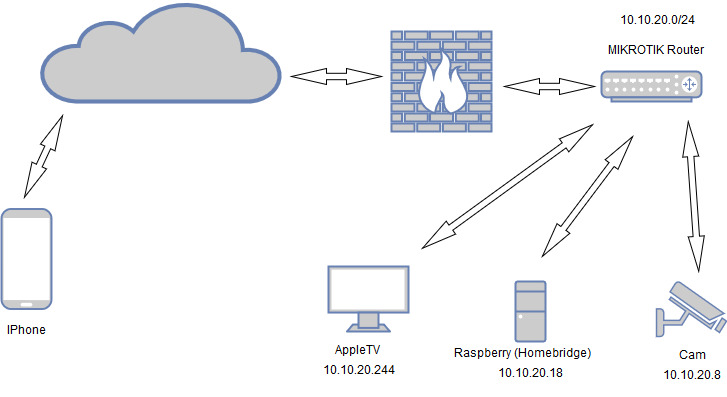

Here a diagramm.
The IPhone initiate a Video Stream (Apple Home App) through the AppleTV to the Raspberry “Homebridge”.
The Raspberry initiate a RTSP Stream on Port 554 of the Cam and redirect it as SRTSP Stream to the AppleTV. From there it should go back to the IPhone (See logs in the previous post).
In LAN everything works, becuse the Raspberry redirects directly to the IPhone IP in the LAN.
The strange is, that sometimes the stream goes through the firewall and sometimes not.
