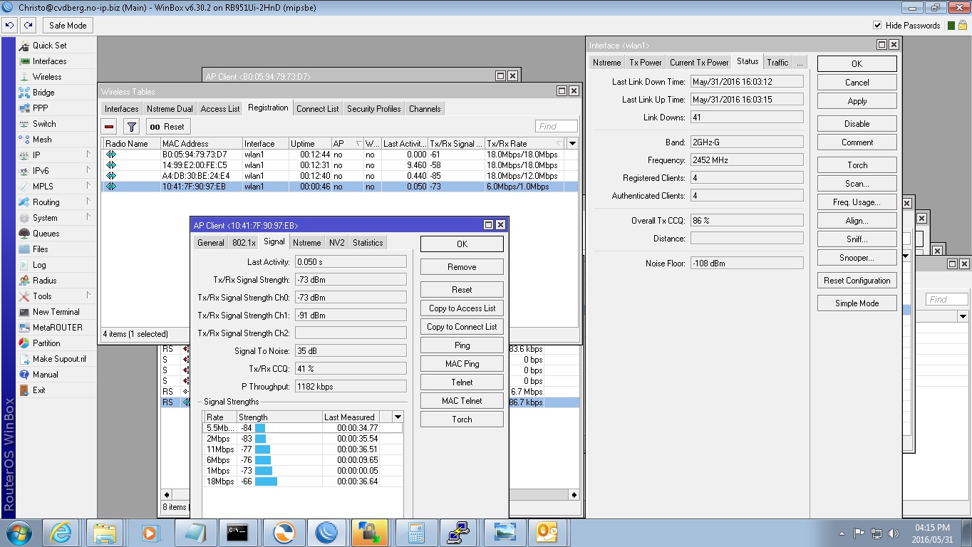

Normis at the moment I have set data rate not to go higher that 18mbts. Also changed tx power back to default. I notice that all other devices usually connects well. Don’t know if it is because he uses iphone s6.
Here is a printscreen of what it shows.
Solved by installing external antennas on the RB951 and also reset wireless to default.
