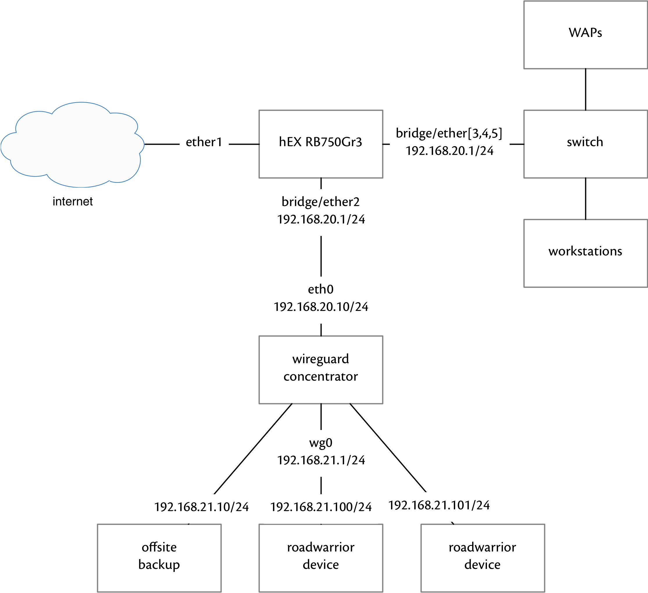

If it’s helpful, here’s a simplified diagram of my network.
The WireGuard network is 192.168.21.0/24. Since I need to access WireGuard hosts from the LAN, I’ve dispensed with the usual masquerade ifup/ifdown iptables rules on the Linux host and added a static route on the RB750Gr3 for 192.168.21.0/24 via 192.168.20.10. This setup mostly works, but connections take like 5 seconds to start moving data from 192.168.20.0/24 to 192.168.21.0/24 after the initial TCP handshake. This problem does not arise with traffic to and from the internet.

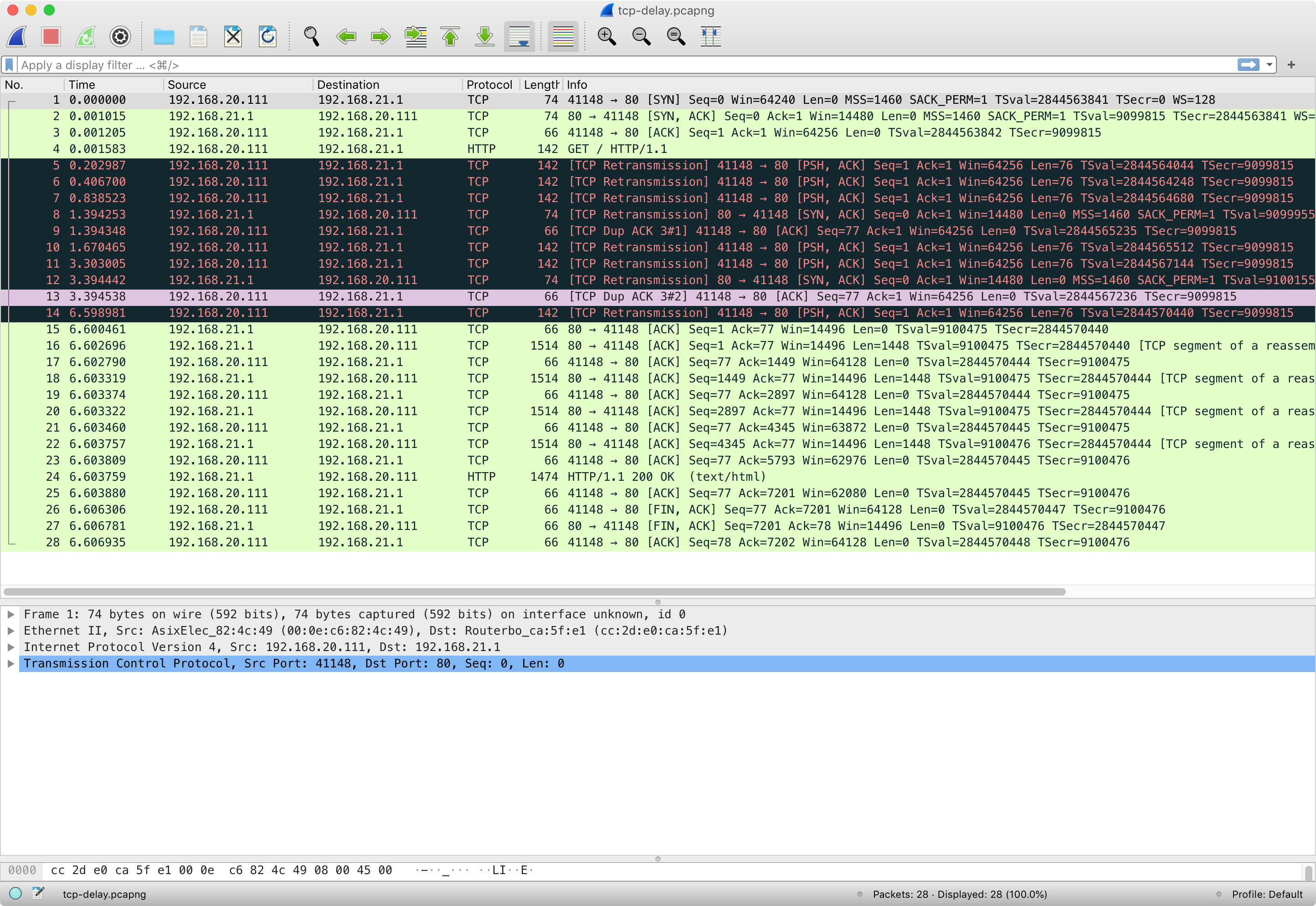

Here’s a screenshot of a representative packet capture. The TCP handshake goes fine, but things go downhill after the testing host sends the HTTP GET.

Seems your target destination (of your static route) is part of existing bridge. I once had similar issue and all was fixed when I enabled bridge firewall:
/interface bridge settings set use-ip-firewall=yes
It just fixed it for me. Maybe someone has better ways to fix this kind of issue.

I’m pretty sure you’re victim of “routing triangle”: when 192.168.20.9/24 host initiates connection towards 192.168.21.0/24, it sends packet to its default gateway (192.168.20.1). That MT takes a note in its connection tracking state and forwards packet to next hop router (WG concentrator at 192.168.20.10). Then the packet proceeds to the destination. Destination replies, packet arrives at WG concentrator which notices that destination address is in directly connected subnet and delivers it directly. Reply packet thus bypasses main router and its connection tracking machine can’t update connection state properly. Next packet, sent from 192.168.20.0/24 host, is then out of perceived connection state and is dropped due to being invalid.
The solution is to disable connection tracking for connections between the two subnets (and hence the firewall filter rule which accepts untracked packets will trigger). Or introduce a new subnet, used solely for connection between the main router and WG concentrator which means WG concentrator will have to pass replies to main router making main router’s connection tracking machine happy. Or stop droping invalid packets. Or something else which will bypass invalid connection state.
