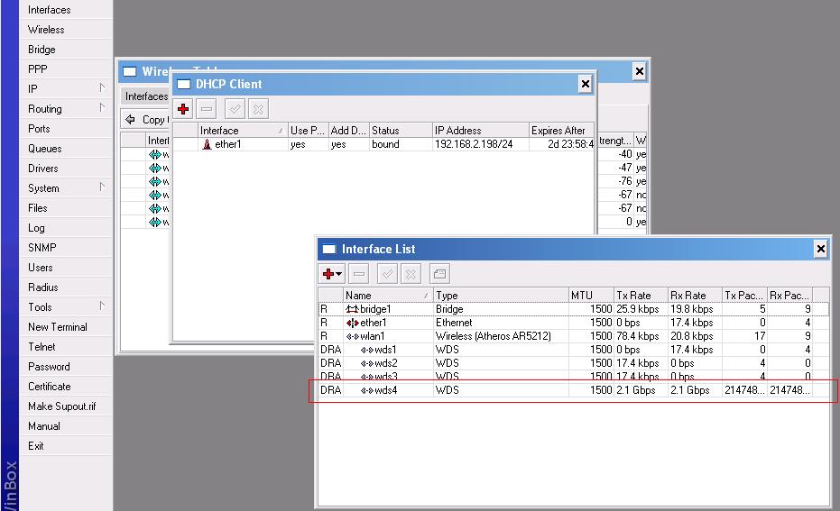

Hi there,
I’m not sure what is causing this but…I have 4 APs in WDS right now working fine, when I try adding the 5th this is where I notice a surge of traffic bouncing around the Network, as you can see from the snapshot it looks like 2.1Gbps of traffic that will appear and then quickly disappear under the Interface list, it will do this until I power down that 5th AP and show for about 1 sec and disappear for about 2 sec, then appear…etc. over and over…causing no one to be able to connect to the wireless once this 5th AP is connected, I have STP enabled in the bridge with ‘eth’ and ‘wlan’ ports in this bridge on all APs.

Does the 5th AP connect to one or two other APs?
You could be getting a loop if it connects to more than one AP.
I was wondering what you meant by connecting to more than one AP, under the wireless registration I see the other AP in WDS, all of them.(4) so to me I would think that it would be connecting to all APs, is this not right, or rather where should I be looking for which it is connecting too, thanks and I really appreciate your help on tihs.

You should configure each AP to be connected to only one other AP.
If not, make sure you correctly set the WDS Cost.

did notice that a route had not been added back to gateway, i’ve since added dst-address 0.0.0.0/0 and gateway 192.168.2.1 to the route list on each AP, would this have caused the traffic loop, I havn’t been able to get back to Enable the conflicting AP, just wondering if this lack of routing might have caused the AP to keep circultating the traffic with no route back to the gateway…
