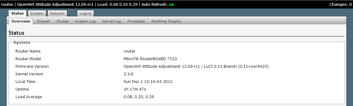

  1. I have router (RB751G-2HuND) on which I installed latest attitude adjustment (12.09rc1) (https://forum.openwrt.org/viewtopic.php?id=39171).

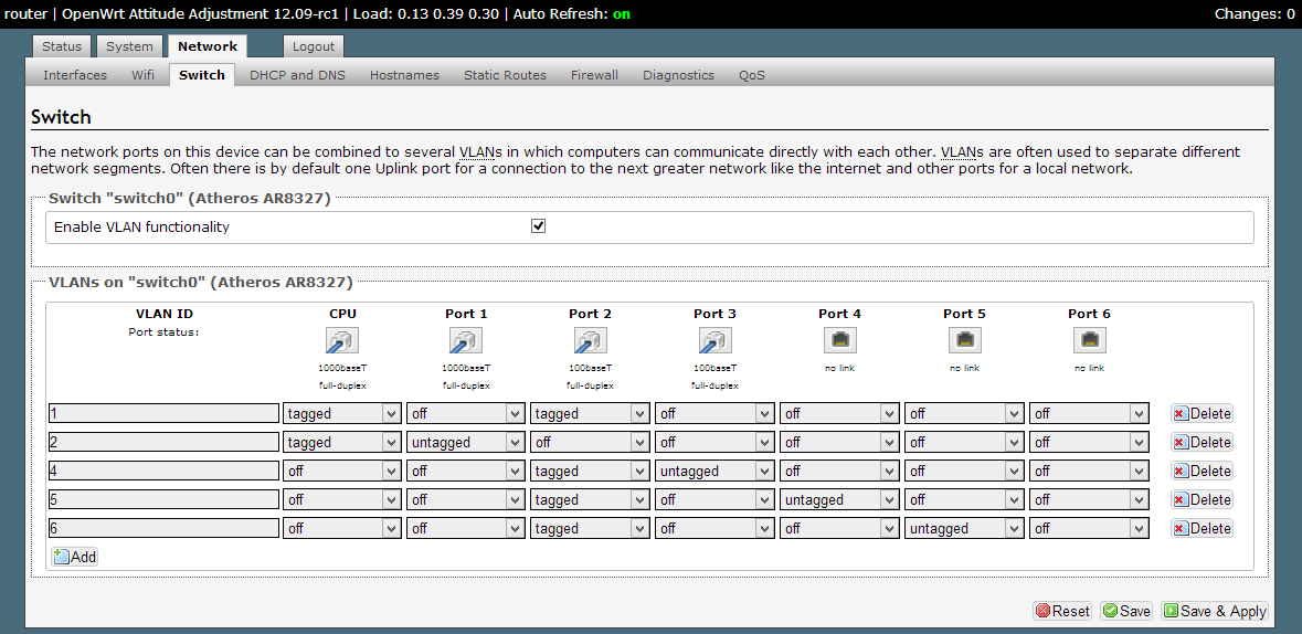

  3. I created 5 VLANs. You can see switch chip configuration on attached screenshot.
    VLAN 1. LAN: untagged Port 2 goes as tagged to CPU. In system visible as eth0.1. eth0.1 is bridged with wlan.
    VLAN 2. WAN: untagged Port 1 goes as tagged to CPU. In system visible as eth0.2. On eth0.2 dhcp-client is being run.
    VLAN 4. untagged Port 3 goes as tagged to Port 2 with VLANID 4.
    VLAN 5. untagged Port 4 goes as tagged to Port 2 with VLANID 5.
    VLAN 6. untagged Port 5 goes as tagged to Port 2 with VLANID 6.
  4. On nucleus I have all VLANIDs configured (eth0.1, eth0.4, eth0.5, eth0.6) and bridged together. So devices connected to port 3, 4 or 5 should always be reachable from router’s CPU port.
  5. Because I only have one other device (Raspberry PI) i did plug it to port 3, then to port 4 and then to port 5. Each time traffic coming from Raspberry PI to nucleus was coming from different VLANID (as expected).

config switch
option name ‘switch0’
option reset ‘1’
option enable_vlan ‘1’
config switch_vlan
option device ‘switch0’
option vlan ‘1’
option vid ‘1’
option ports ‘0t 2t’
config switch_vlan
option vlan ‘2’
option ports ‘0t 1’
option vid ‘2’
config switch_vlan
option vlan ‘3’
option vid ‘4’
option ports ‘2t 3’
config switch_vlan
option vlan ‘4’
option vid ‘5’
option ports ‘2t 4’
config switch_vlan
option vlan ‘5’
option vid ‘6’
option ports ‘2t 5’
