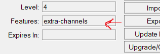

You need a extended license. You can buy from mikrotik website

Dude for advanced channels u need this
Just contact mikrotik support and follow the instructions (u need to fill a form that u will not use this option agains the law bla bla bla …)

You can first read the documentation yourself. Lakis is wright, and You’re wrong because now extra channels is active again. Nobody is talking about buying this feature. If you write to MT support, you can update free your license to extra channels. Without it, it’s impossible to use 40-60Mhz channels.
