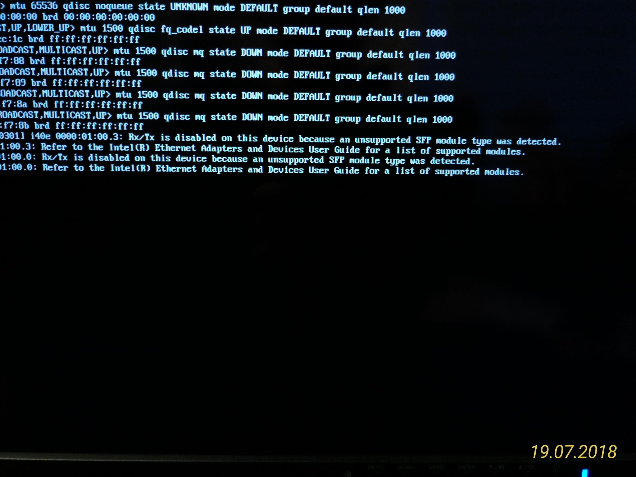

Apparently they’re not.
Luckily I had Mikrotik 1m DAC laying around so I tested it before ordering more cables. It doesn’t work. I also tried Mikrotik’s SFP+ FC module and it doesn’t work either. Card shows following error:
I ordered Intel compatible DAC cable. I hope it’s gonna work :confused: I’m starting to be a bit afraid that this card is from some OEM and accepts eg only HP or Dell parts… I bought it in some standard consumer electronics shop. dmesg shows following message:
[ 6433.461982] i40e 0000:01:00.0 enp1s0f0: the driver failed to link because an unqualified module was detected.
