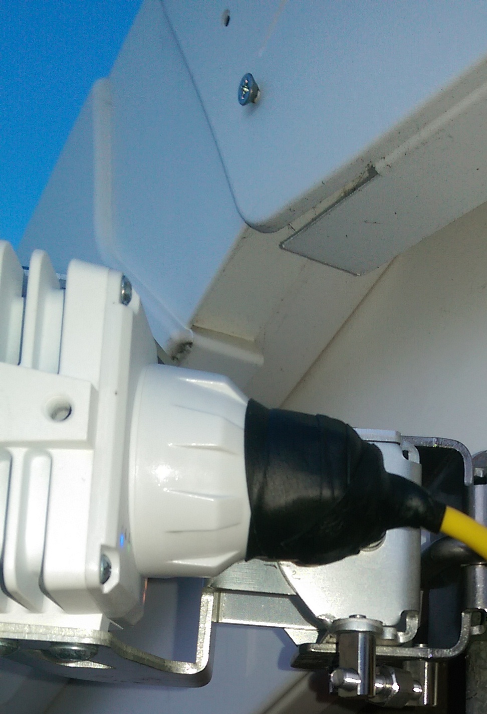

Just remember to put some amalgamanting tape on the ethernet inlet to stop any water getting in.
