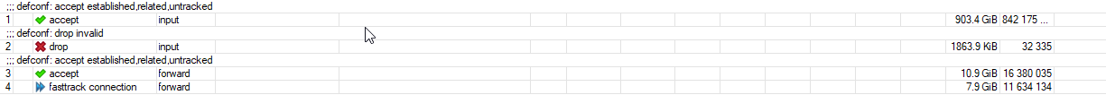

are this rules on the top mandatory?
add action=fasttrack-connection chain=forward
what do you think about this 3 rules on the top of the firewall? If I dont put fasttrack my cpu goes to 50,60%. It is ccr 1008.
First two rules are for input chain, the 3rd, fasttrack is for forward chain and has nothing to do with first 2 rules.
Also not sure I understand your question?
my q was, does it something thats a MUST HAVE this input chain rules to have most of the benefits of the firewall. Is there some updated firewall rules for preventing intrusions?Maybe someone to share their firewall without sensitive data ofc

There is no such thing as “the top of filter”. There is the top of chain input in filter, and there is the top of chain forward in filter. Packets always only go through one of these rule chains, not both.
So the default firewall of the SOHO grade devices is the optimum one:
add action=accept chain=input connection-state=established,related,untracked
add action=drop chain=input connection-state=invalid
… individual permissive rules if necessary for IPsec and other VPNs and/or for direct remote management via secure protocols…
add action=drop chain=input in-interface-list=WAN
If you don’t want to permit access to router management from anywhere in the LAN, add permissive rules for authorized LAN devices where indicated and remove the in-interface-list=WAN from the last rule in input.
Adding the rules I’ve suggested to raw may reduce the CPU load. You have to try, it depends on your traffic structure whether the difference will be noticeable or not.
In forward, the structure is basically the same, except that the action=fasttrack-connection rule must be followed by action=accept chain=forward connection-state=established,related,untracked because some small amount of packets belonging to fasttracked connections takes the full path through the firewall, and if you use bare IPsec with policy matching, it must be preceded by action=accept chain=forward connection-state=established,related,untracked ipsec-policy=in,ipsec and action=accept chain=forward connection-state=established,related,untracked ipsec-policy=out,ipsec as connections which need to be handled by IPsec policies must not get fasttracked. In special cases, these rules exempting connections from fasttracking have to be more complex (where NAT is necessary in order that the packet matched the IPsec policy, it doesn’t match the ipsec-policy=in|out,ipsec while being handled in filter), so you need to use src-address(-list) and dst-address(-list) matching, connection-mark matching etc. there.
but then i got problem then with dude just “getting stuff” but nothing happend than, and when disable fasttrackk it came and everything is ok. Dude is a mikrotik which is located on another HQ and been connected via ipsec to this mikrotik where i put these comands.
And router is going up to 70% cpu, and when put fasttrack it came below 30. I see in tool profile that firewall consume about 30% of cpu but cant find why.

      chain=forward action=drop connection-state=invalid
 5    ;;; Drop Inv.
      chain=input action=drop connection-state=invalid
 6    ;;; IN-Phase_dropRAW
      chain=input action=drop src-address-list=@Servisi_Phase log=no
      log-prefix=""
 7    ;;; IN-Block shodan
      chain=input action=drop src-address-list=shodan
 8    ;;; IN-Defend from pingers
      chain=input action=drop src-address-list=pingers log=no log-prefix=""
I have posted in thread tunnel troubleshot a log and ip ipsec installed-sa print results at the time tunnel dont work. But what is strange.
I have LAN subnet which are all created by MikroTik and anothers which are on the Cisco L3, maybe the drawing make you easier to understand.
So, subnets which are creating a tunnel is maked on mikrotik and on cisco. And someday one have a problem and not the another, and so on. Then, one subnet for example 192.168.50.0/24 dont see 10.11.0.0/16 even if status is established and have access to 10.10.0.0/16, and so on.
There are more ipsec and on the other side there is some directly connected subnets (not all are openvpn, some is directly connected to pfsense).
10.10.0.0/16 and 10.11.0.0/16 are remote locations not phisically in the building where is pfsense
Let’s keep the threads (firewall and IPsec) separate.
Here, try to enable only the three mangle rules you’ve added, but keep those drop ones, which you’ve eventually added since the point in time when it was working, disabled, and tell me how it works.
i cant enable JUST those three in mangle, because here i mangle some subnet and force it to another ISP in routes and also using for VOIP, so i cant disable it.
I had in mind “out of the rules added by my recommendation, enable only the three added to mangle, not the drop ones in filter”. Of course all your pre-existing rules must stay in place.
Also, from your print of drop rules, it seemed to me that the drop one in forward in filter was not the very last one in that chain. The rules are matched in sequence, first towards last until first match to a rule providing a final verdict, in the chain chosen depending on packet type: incoming to router itself, i.e. no out-interface used / forwarded from interface to interface / outgoing from router itself, i.e. no in-interface used.
it is how it was earlier, i just added that three in mangle if you think about these rules
add action=accept chain=forward connection-state=!new disabled=yes
add action=mark-connection chain=forward comment="mark ipsec connections" \
    disabled=yes ipsec-policy=out,ipsec new-connection-mark=ipsec passthrough=\
    yes
    disabled=yes ipsec-policy=in,ipsec new-connection-mark=ipsec passthrough=\
    yes
and you saw drop rules in filter, dont sure what you point, i have the rule number four same as number one, and i will remove it.
   ;;; Drop Inv.
