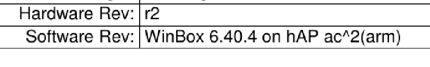

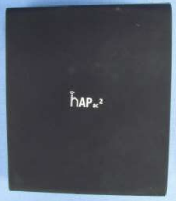

RBD52G-5HacD2HnD-TC just popped up on FCC web site.
they refer to it as hap ac^2
it is supported already by 6.40.4, i found no data on cpu, could be one like the Qualcomm IPQ-40xx maybe but neither of them is triple chain: https://www.qualcomm.com/products/ipq4019
