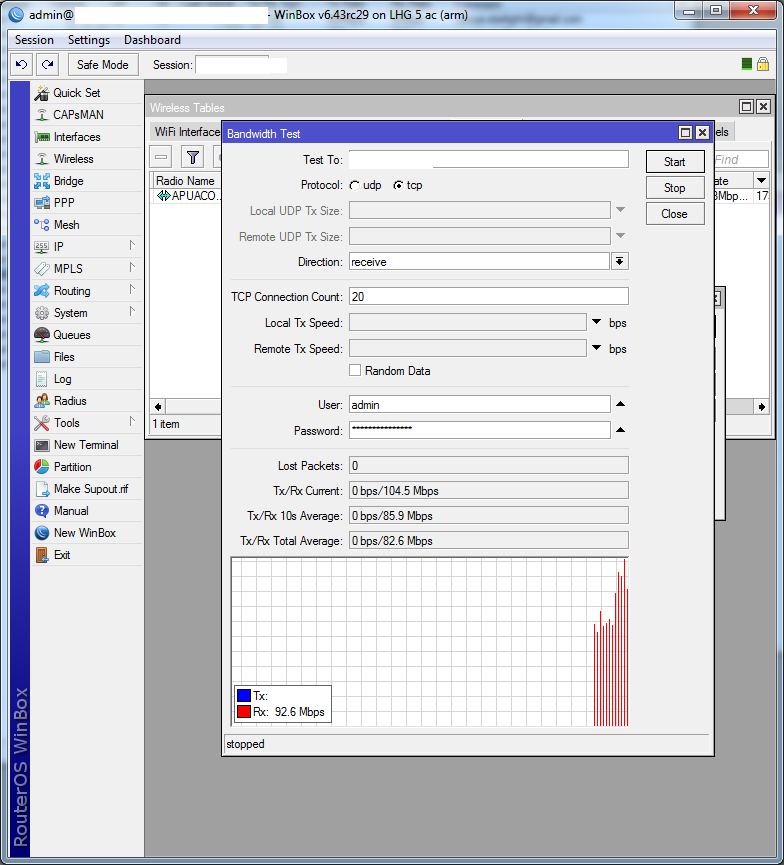

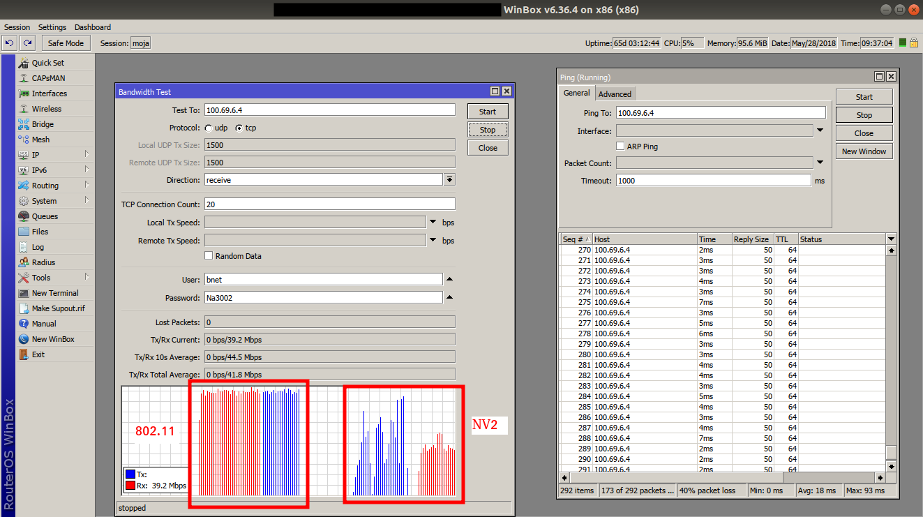

  1. PtP link with 2 LHGs AC (bridge mode, ROS 6.43rc29) - with 802.11 protocol we have 90/90 Mbps (download/upload) - limit of 100M ethernet on both ends, tested from x86 router to another x86 router (in between only two LHGs). When I changed to nv2 protocol (did not touch any other settings) throughput is not stable, as per image

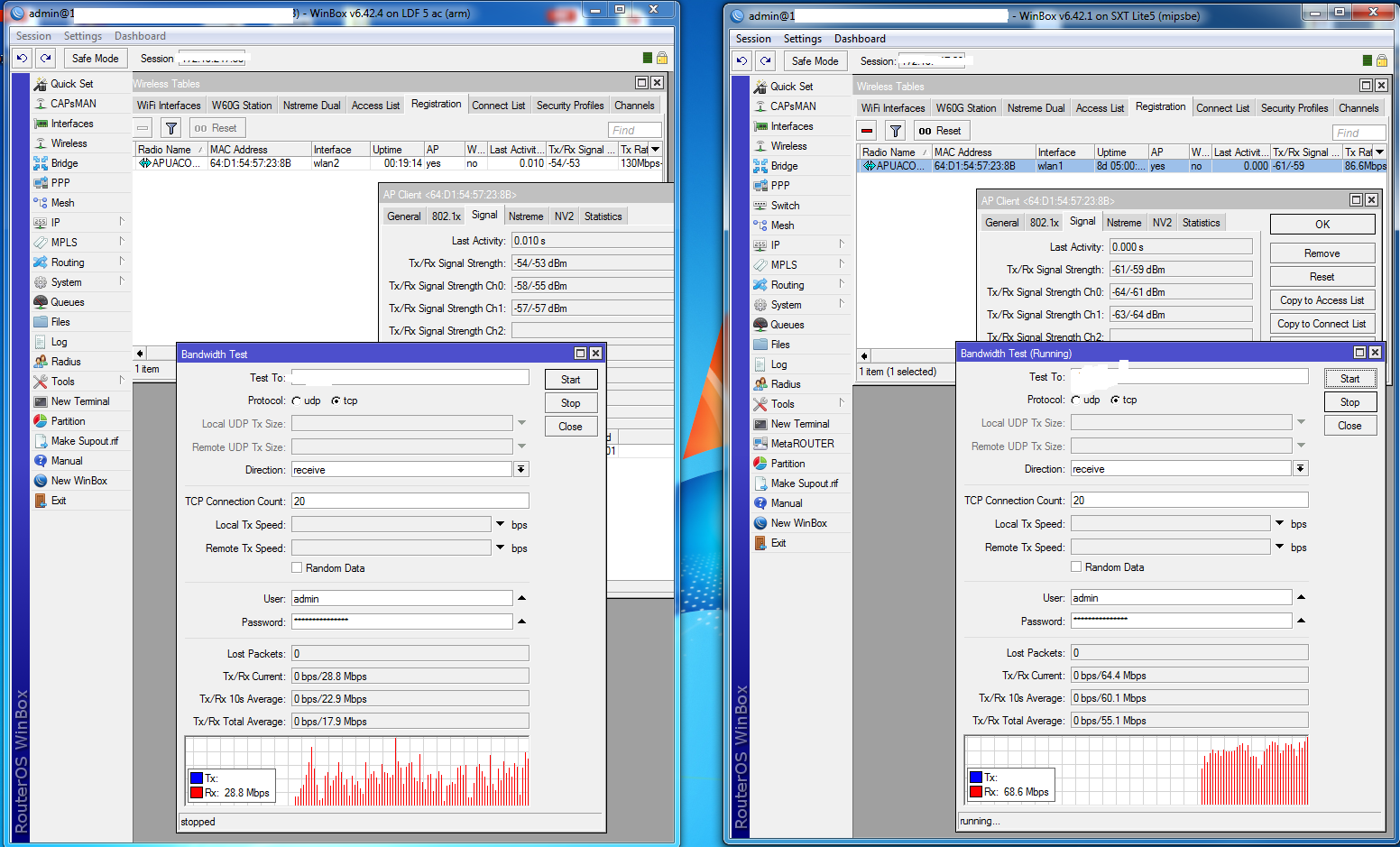

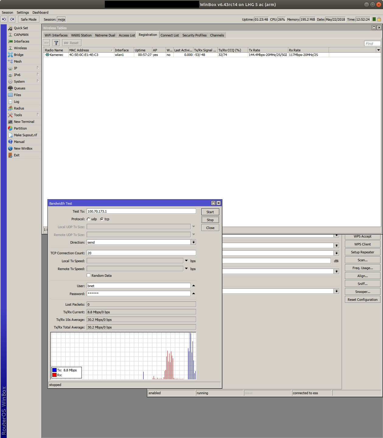

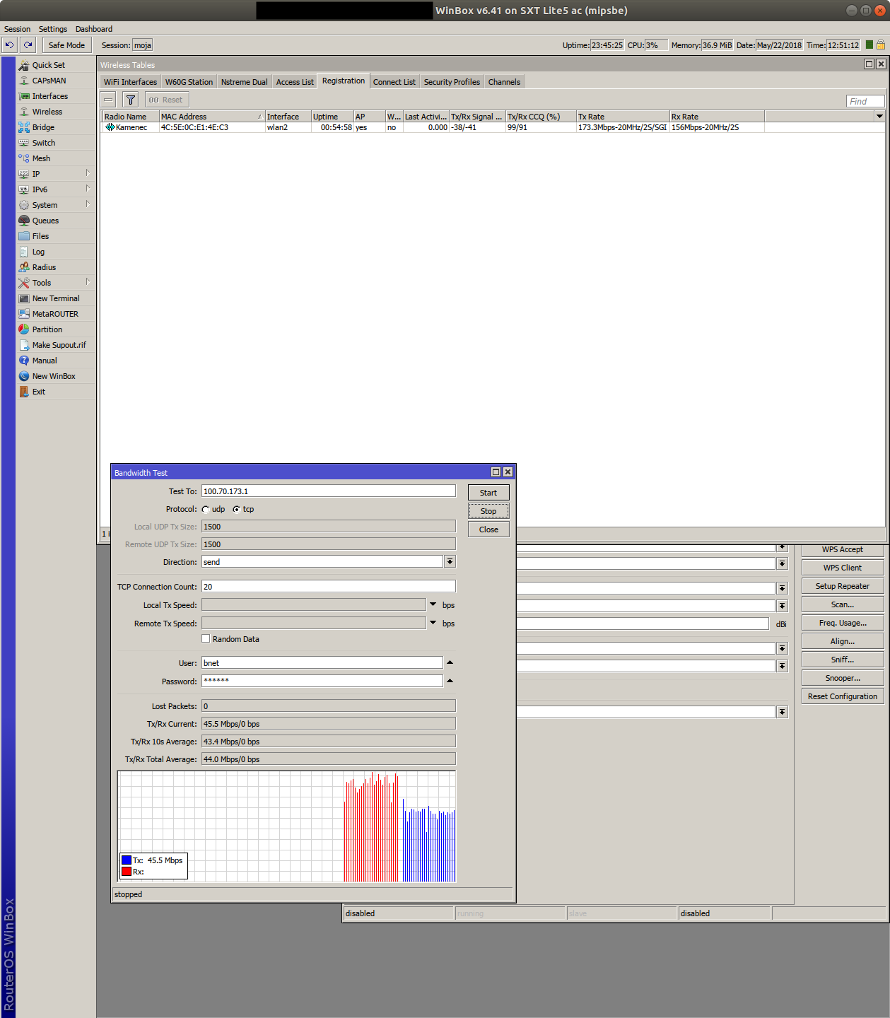

  2. PtMP - AP RB922, ROS 6.42.3, 7 clients. One of out technitians have his client device (SXT AC, ROS 6.41) and we mounted LHG AC (ROS 6.43rc14) next to it. Results:
    We reported this problem to Mikrotik but no solution at the moment.

What if you compare it with ARM and 802.11 protocol (not NV2), what is the speed then?
Normis in 802.11 works like a charm :slight_smile:
