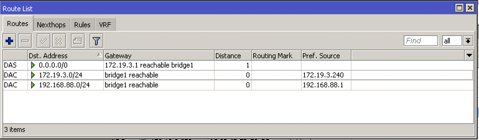

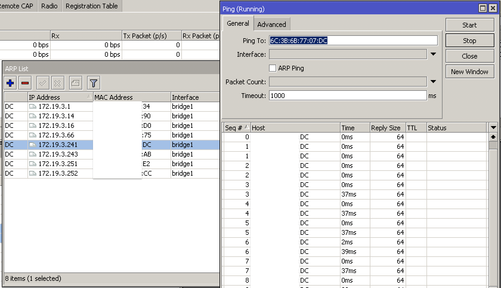

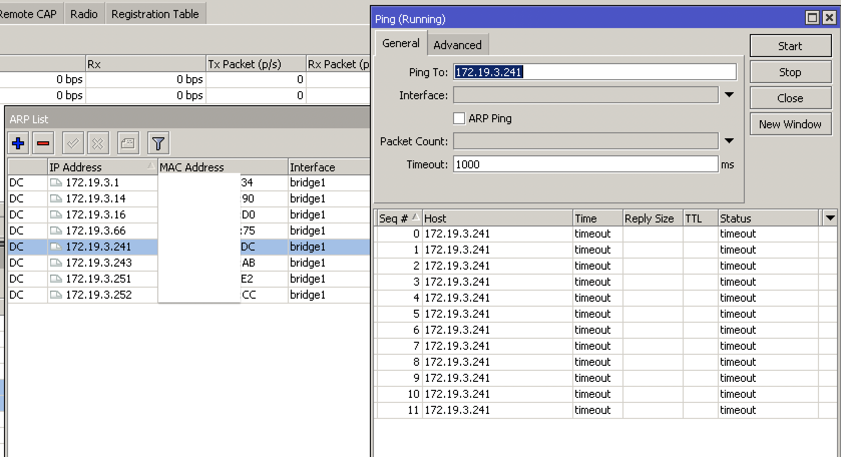

In my network I’m able to ping a device using the ARP, but when using the IP Ping methode I cannot reach the Mikrotik AP. Any idea’s? What could be the reason?
The Mikrotik AP is connected to a HP switch which has another Mikrotik AP, ping that 2nd AP using IP and/or ARP is working fine. So I can reach the switch to which the AP’s are connected.

Pinging “the problem AP” from the 2nd AP on the same HP switch, is working.
Pinging the device from which I cannot do the ping from the AP is working. In other words, the reserve IP ping is working.
Firewall?
Nope, then I would not be able to ping the other AP on the same switch.
Firewall is not enabled in this section of the network.
