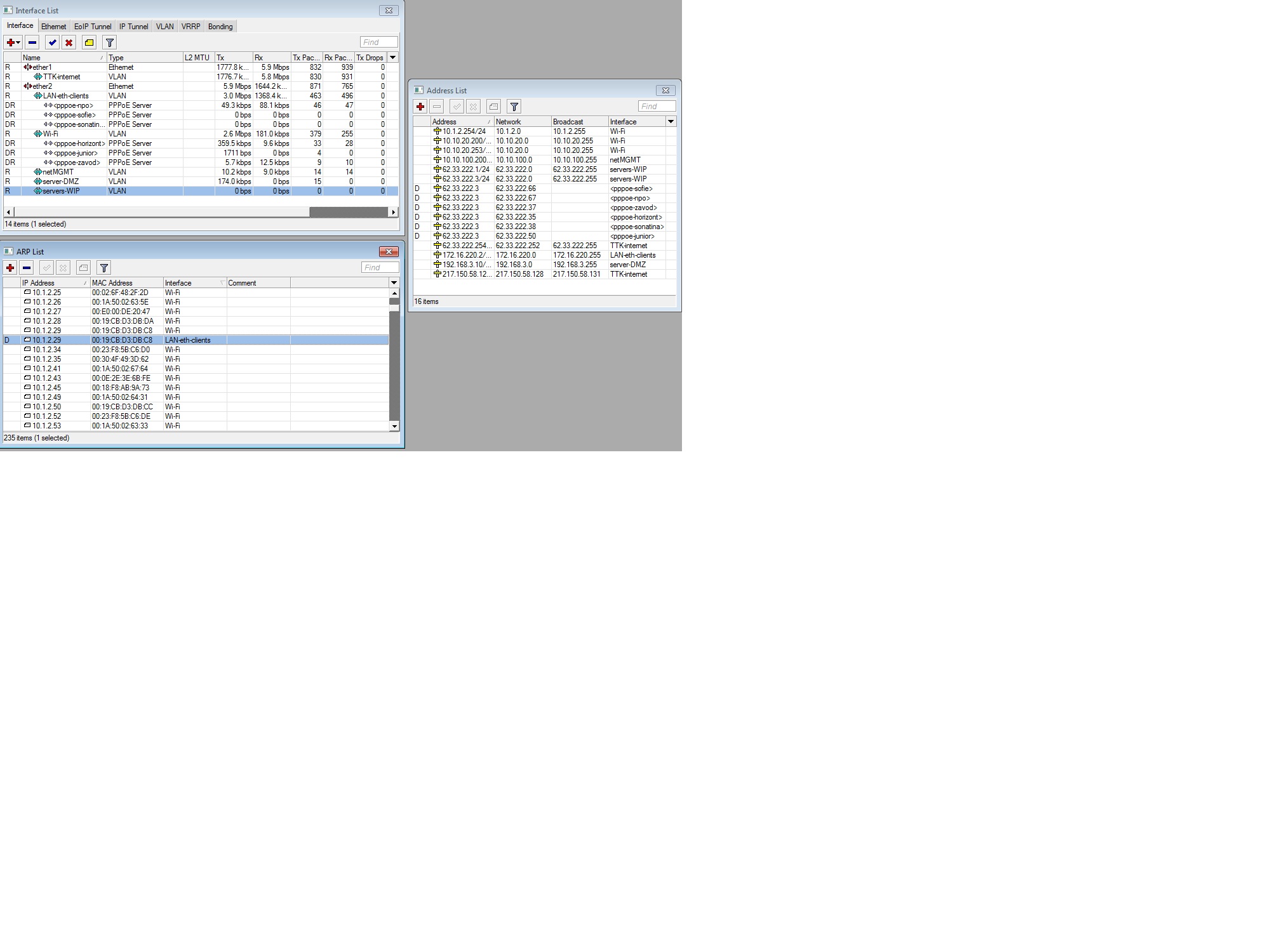

    and a problem that in the ARP table i have for example static record IP=10.1.2.29, MAC=00:01:02:03:04:05, Interfaice=WiFi
    and mikrotik add dynamic record with the same IP and MAC BUT wrong interfaice Lan-eth-clients.
Pls help! I don't understand why, try to search many forums, wiki, docs..... My braid... ahh!

good ARP:
226 10.1.2.29 00:19:CB:D3:DB:C8 Wi-Fi
wrong ARP: !!!!!!!!!!!!!
231 D 10.1.2.29 00:19:CB:D3:DB:C8 LAN-eth-clients
HELP!

i run torch on both WiFi interf. and Lan-eth-clients interf. and i see some packets coming from VLAN interfaice WiFi from another subnet… 172.16.220.xxx BUT i don’t understand WHY they coming… i check almost all switches across network and did not see and miss-config…
