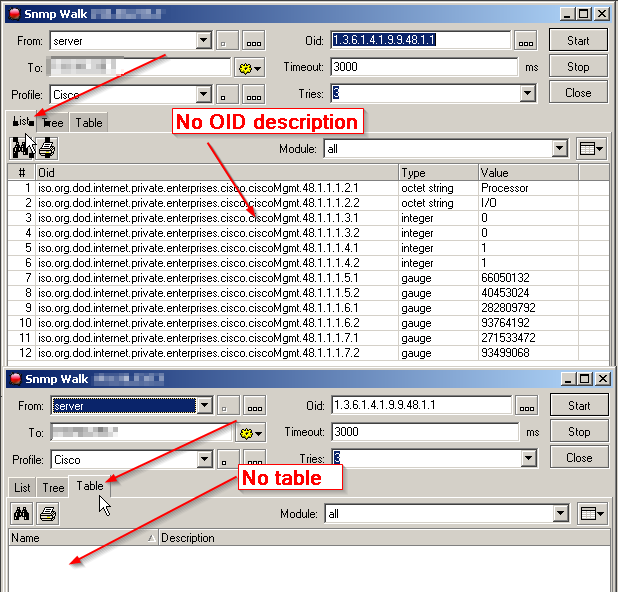

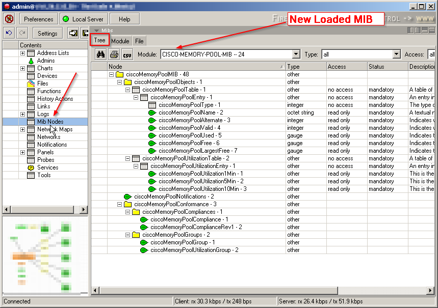

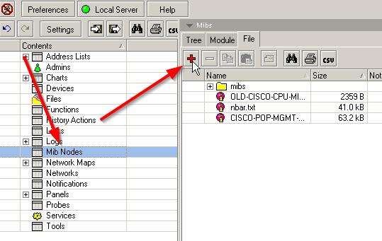

Is it loaded in The Dude? If not - load it.
When loaded, MIB becomes “compiled” so you do not need to do any more steps.
After it, while snmpwalking you will be able to open table in snmpwalk utility
For a sample.
Before loading cisco Memory MIB
After it.

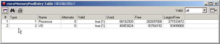

Go to the next post.
And you can dobleclick on the table name and will see the table as on picture below
