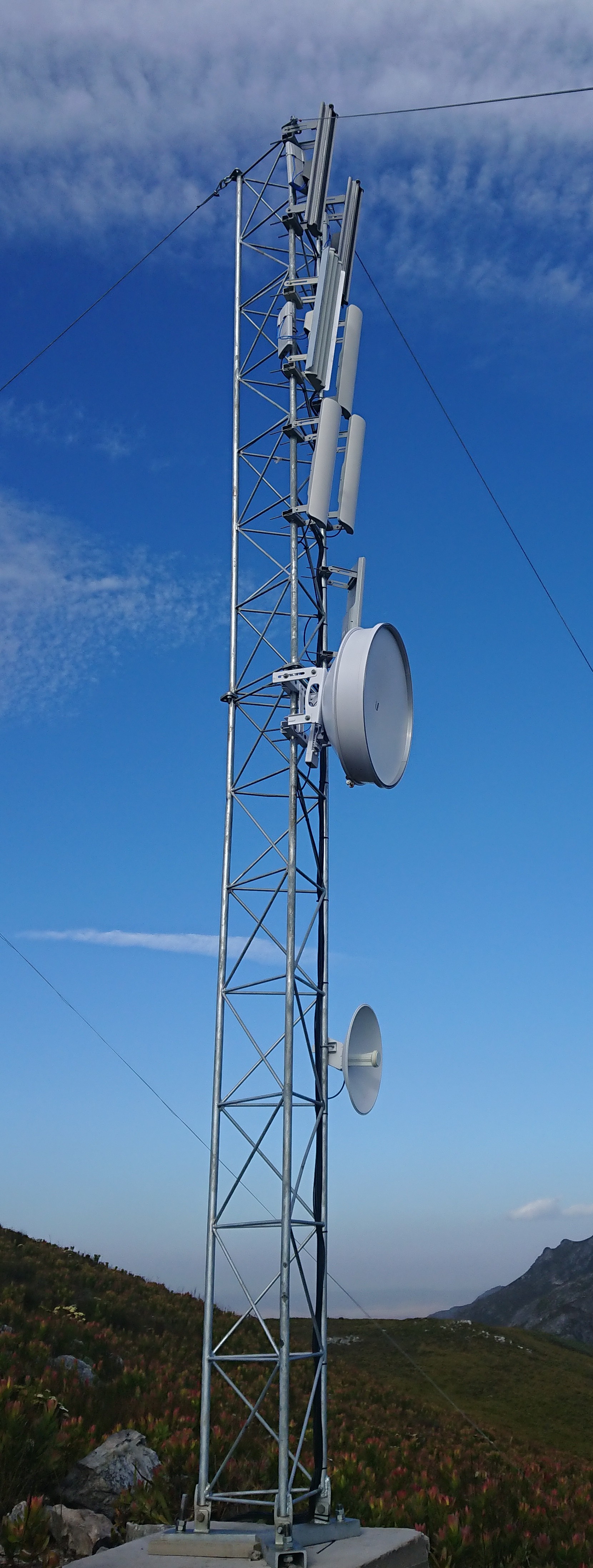

You wrote about sector APs in a tower. With 60° sector antennas you could place six APs in the same tower, which could serve the 300 clients from a single point - if the clients are distributed evenly around the tower and reasonably close. How about two or three towers with three 120° sectors each? How about sector antennas around the perimeter aimed in towards the users?

we planning using 3 sectors in single tower because our client in one residential.
each sector using AP RB 800 and mini pci R52HN and power using poe distribution and we have UPS for this.
is this possible using RB 800 to handle it or any better radio for this ..?

RB800 is a good choice very fast and stable
You can use R52Hn or SR71-15 or F50N-PRO Mini-PCI
Another good choice is SXTG-5HPnD-SAr2
Guessing you’re going to use 3 120 degree sectors to cover a full 360 degree around the site?
The RB800 should be fine for that (although never even seen it) but get some decent sectors antennas with noise isolation/shielding.
For clients I’d either use SXT (closer), Disc (medium) or LHG (far). All of them should be OK.
If you’re running Mikrotik only, I’d suggest using NV2 protocol and using the latest 6.42+ software for the increased throughput fix.

mbfound thanks for reply yes we want to cover 360 degree and i think using 3 sector 2.4Ghz and 3 sector 5Ghz and total we have 6 sector.
you have some advice what best sector antennas for this..?
I would avoid using 2.4Ghz, it’s a very noisy spectrum and very few channels available.
I did post a link above to the sector antenna, but here: https://www.ubnt.com/airmax/airmax-sector-antenna/
They come in 2.4Ghz and 5Ghz (The adjustable Titanium range). You can run them with a Netbox5 for the 5Ghz sectors and a Basebox2 for the 2.4Ghz sectors.
I would avoid the RB800 and go for a modular approach to save some future headache but even that would work with a daughterboard and a few wireless cards.

Have a look at the top sectors, the basebox/netboxes will just act as the AP/sector and the routing/pppoe server will sit on another device (RB3011 in this case).
rb800 is an old way to do things
i refer to the model of one CPU with many radios, that was valid an very popular decades ago but not today
nowadays designs have migrated for single Radio per equipment to improve performance and isolate radios between them, preventing self interference
finally rb800 gets you an expensive less performance solution than separated equipment:
for example you get a rb800 and every thing you need to get 4 radios operative with 19dbi 120° antennas you spend close to 1.200 US
instead of that you get 4 mantbox with the same antenna plus a powerbox pro to power it in group you spend only 900 bucks and get best performing solution without the hassle of managing pigtails from radios to antennas
The Mantbox 19s is a cheap and good performing solution, but it is not a good solution overall. As a wireless engineer you should cherish and preserve spectrum by using best possible basestations. Cheap antennas will pollute big chunks of spectrum for miles so it’s akin to shooting oneself in the foot!
I wish more people would think like you, good shielded antennas with only as much degrees as need and adjusting output power as low as possible instead of just blasting everything on max.
