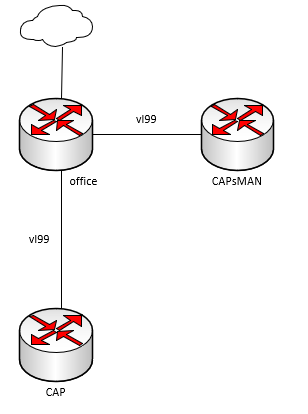

i’m providien my config of my CAPsMAN and one cap.
Im wondering how you can put your config that you mentioned above

/ interface wireless cap pr
                            enabled: yes
                         interfaces: wlan1
                        certificate: none
                   lock-to-caps-man: no
               discovery-interfaces: br-v.vl99
                 caps-man-addresses:
                     caps-man-names: cap.ovpn,office-Sydney
  caps-man-certificate-common-names:
                             bridge: br-cap
                     static-virtual: yes
als also i got dhcp-server on vl101
in this particular config, got can use dhcp-caps-manager?

In the example you’ve posted, both caps-man-names and discovery-interfaces are set. Leaving asside that it is strange to have both set, you must have configured them manually, i.e. you had to log in to the CAP and set its configuration.
i’m scared that will not fit i’m ny config. i got vlans between all devices. And i got local-forwarding for some reason.
That is most for bridged configuration. I’ll play around
