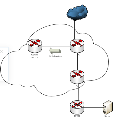

In my case i’m using CGNAT, which is working well!
I’m sharing only one public ip-address for my clinets.
What im trying to do now is, port forwarding for the server (client).
E.g. is simple, CPE01 is the end user and they have some server , and they what to use port forwarding fot that.
Any tip how can i do that?
Just note here, the publis ip-address is terminated on CGNAT router, I can do port forwarding to the CPE01(if ill do nat rule on cgnat router),. but i want to be able to get server on it.
Please see the topology

let say CGNAT is R2 which is connected to the gateway router (R1), and i have assigned only one public ip-address (R1==>R2) for some customers (i’m sharing the public ip-address,that is the purpose of cgnat).
Everything works fine, just im wondering whether i can do port forwarding for the server (client), which by theory is hard to say yes.
OK, I think I understand what you’re doing now. The short answer is yes, you can port forward to the client.
What I would do (based on your picture) is to forward the port for the external IP address from R1 to R2 and then R2 forwards the port to CPE01. The client (or you if you have access) will need to forward the port from CPE01 to the server. I’ve usually seen these arrangements called Double-NAT (although it looks more like Triple-NAT in this case with the client having a router) rather than CGNAT but the principle of the forwarding is the same.

I cna do PF to the CPE01 , if i conf that rule on CGNAT-router.
My goal is how to involve the server on that

On the router with public address, there must be a action=dst-nat rule with to-address=the.cgnat.address.of.customer.router
On the customer router, which has a CGNAT address on its WAN, there must be an action=dst-nat rule with to-address=the.lan.address.of.the.server.
The server itself doesn’t need to do anything except listening at the private address.
If you want it complex and dangerous, you can permit UPnP on the customer router, and teach the server to request dynamic creation of a dst-nat rule on the customer router using UPnP.

I was trying to say that i want to be able to do port forwarding to the Server.
On the router with public address, there must be a > action=dst-nat > rule with > to-address=the.cgnat.address.of.customer.router
i did try, that will allow me to do PF to the CPE01 only
On the customer router, which has a CGNAT address on its WAN, there must be an > action=dst-nat > rule with > to-address=the.lan.address.of.the.server> .
on the CPE uplink ip-add is 10.0.10.x and the server is 192.168.1.x
that why im getting stuck

The issue is from CGNAT i can’t ping the server ip-ad (192.168.1.x) which is logical.
That why i can make it work.
This is basik e.g.
add action=dst-nat chain=dstnat dst-address=1.1.1.1 dst-port=8080 in-interface-list=WAN protocol=tcp to-addresses=192.168.1.z to-ports=80 (server)
add action=dst-nat chain=dstnat dst-address=1.1.1.1 dst-port=8222 in-interface-list=WAN protocol=tcp to-addresses=10.0.1.x to-ports=8291 (CPE01)

  • CGNAT -
    add action=dst-nat chain=dstnat dst-address=public-ip dst-port=89 protocol=tcp to-addresses=CPE-ip to-ports=80
  • CPE -
    add action=dst-nat chain=dstnat dst-address=CPE-ip src-address=public-ip to-addresses=server-ip
