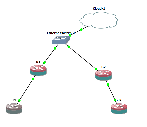

I have been testing many tunnel like EoIP-IPSec, IPIP-IPSec, L2TP-IPSec. Only i found that this rules makes traffic when i’m playing with tunnel mode, on any other it doesn’t make any traffic at all.
i’m waiting for your comment
This log comes form R1 and it says:
IPsec_IN = 0c:5b:54:40:0b:00 belongs to “R2”
IPSec_OUT = 0c:5b:54:98:f9:00 belongs to “cl1”
