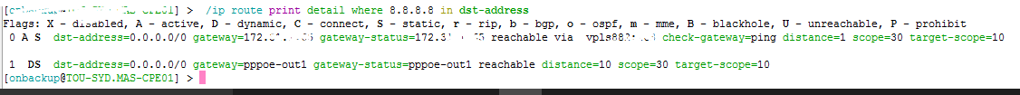

Since dynamic routing (OSPF) is active, what does /ip route print detail show? And what src-address you must add to ping 8.8.8.8 in order that it worked?
wow do you want me to post here? from the ospf i’m receiving 700+ routes
To be able to ping to google im need to src with 192.168.0.1
OK, so post just the output of /ip route print detail where 8.8.8.8 in dst-address , that should be just a few routes.
this is what i can see:
What I can see is that the action=src-nat rule matching on out-interface=vpls-xxxx (through which the current default route goes) is restricted to src-address-list=OriginCustomer. Whereas 192.168.0.1 does match that address list, the own address assigned to that interface (172.31.1.66), which is chosen for own outgoing traffic of the 3011 via that interface, doesn’t. So I suspect that somewhere between that interface and the internet, route to 172.31.1.66 sends the ping response somewhere else than back to the 3011. OSPF doesn’t take care about 172.31.1.64/30.
