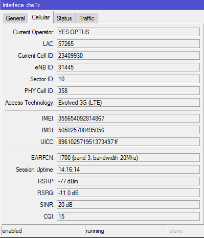

We are using mikrotik LHG R 6.45.8 (long-term). with LTE
Everything works properly for a period of time, then internet connection become poor, and as soon as i reboot anntena it self everything back to normal.
is there any tips and tricke how can i avoide reboothing
that is the current LTE resoulte see picture

Signal measurements, shown in screenshot, are weird. RSRP (signal strength) is pretry good at -77dBm while RSRQ (signal quality) is relatively bad at -11dB. As modem reset resolves the problem fir a while I’d say modem is misbehaving and modem FW upgrade is recomended thing to do IMHO.
