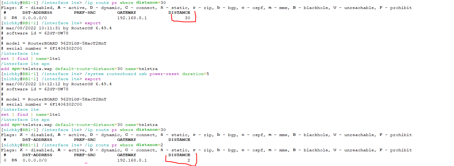

I’ve added an /interface lte apn row with a non-standard apn value, and configured the /interface lte to use that row. It survives both a restart of the LTE modem using /system routerboard usb power-reset and a reboot of the whole router.

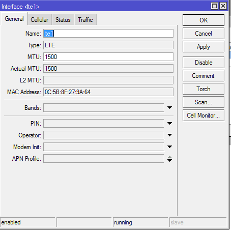

this will explain more. I’m losing APN profile after reboot or unplug/plug
What does /interface lte export show before the reboot when it works and after the reboot when it doesn’t? And what is the RouterOS version?

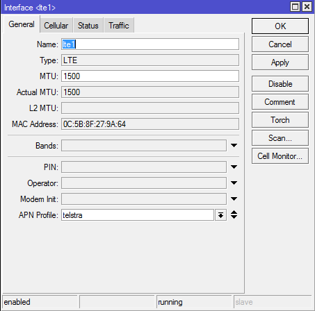

In LIT.PNG you show I see that you add second one APN… but if you use only one LTE device then easier is ‘set’ command to modify default APN, not ‘add’ next one.
To me it seems that even though you tell the LTE interface to use the APN profile named telstra using Winbox, this setting has not made it to the configuration. So try setting it using the command line - /interface lte set lte1 apn-profiles=telstra, and see whether a subsequent export shows it, it should now read
/interface lte
set [ find ] apn-profiles=telstra name=lte1
If it does, try to reboot the modem by USB power cycle again; if it doesn’t, it is a bug of storing the configuration.
