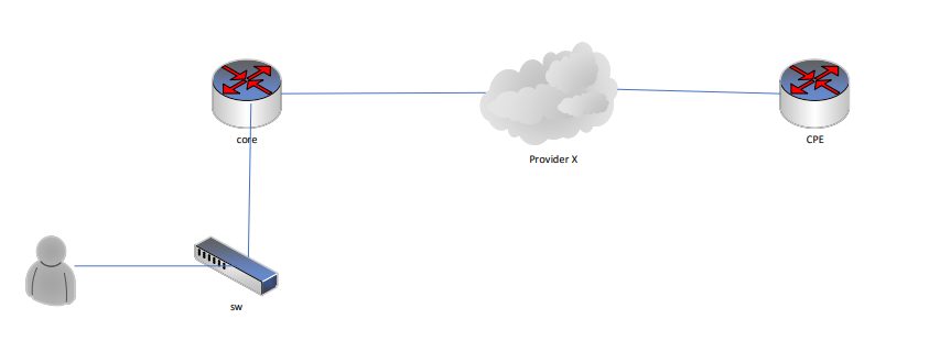

by using PVLAN how can i play with service tag?
I need that in my case.
without PVLAN works well!
Too vague for me.
Concur PVLAN=?? Port Vlan?? in which case tags dont come into play??
Service Tag = 1st VLAN tag (or Stacked/Provider S-VLAN) on “QinQ” (2nd is Client/User C-VLAN)
i’m trying to establish layer 2 connectivity.
So i can get this done by using “user service tag” on my device and customer
that works fine because it can provide tunneling method, and i don’t need to contact my upstrime provided to add more vlans, The upstrim provider is doing layer 2 connectivity for me by using vlans.
When im using PVLAN i’m not able to achieve that.
My gold is to do same thing by PVLAN, otherwise there is lot of mess
If I understand well, you use Service Tag inside a VLAN of your provider?
Do you do “QinQ” / S-VLAN + C-VLAN for add another VLAN?
I’ve never had to add a third layer of VLAN (QinQinQ?) before, I don’t know if that’s possible, and there has to be supported from the ISP.
At most I can advise you to establish one or more EoIP (Ethernet Over IP) link between the two parties and use it like VLAN.
Better to get other Service Tags (C-VLAN???) assigned by the ISP.
i was thing if to use “use service tag” by using vlan-filtering, but it seems that is not possible for now.
Thanks @rextended that will do with EoIP.
I can ping with size 1500, which is what i want.
I wish if i can bridge other tunnels such as “ipip” and “gre”, maybe that in v7 :wink: . I can use BCP, ye there is so many options
