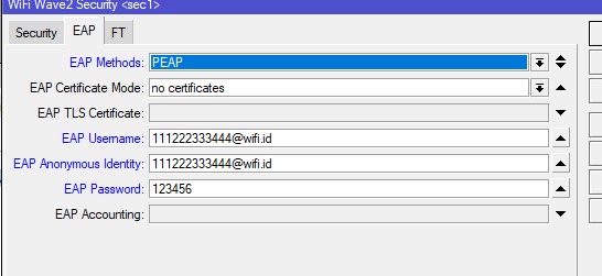

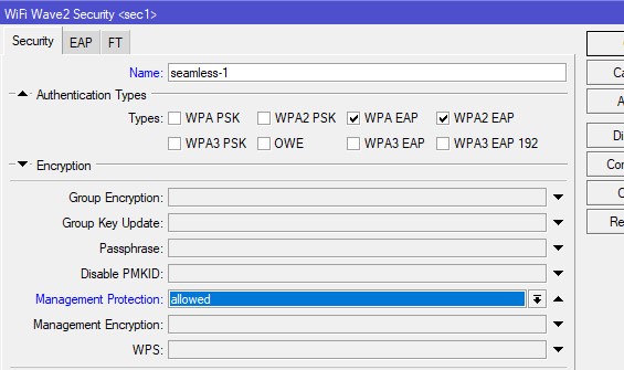

Try setting it up like this
Thank Ca6ko for your respon.
I try it, but can not connect.

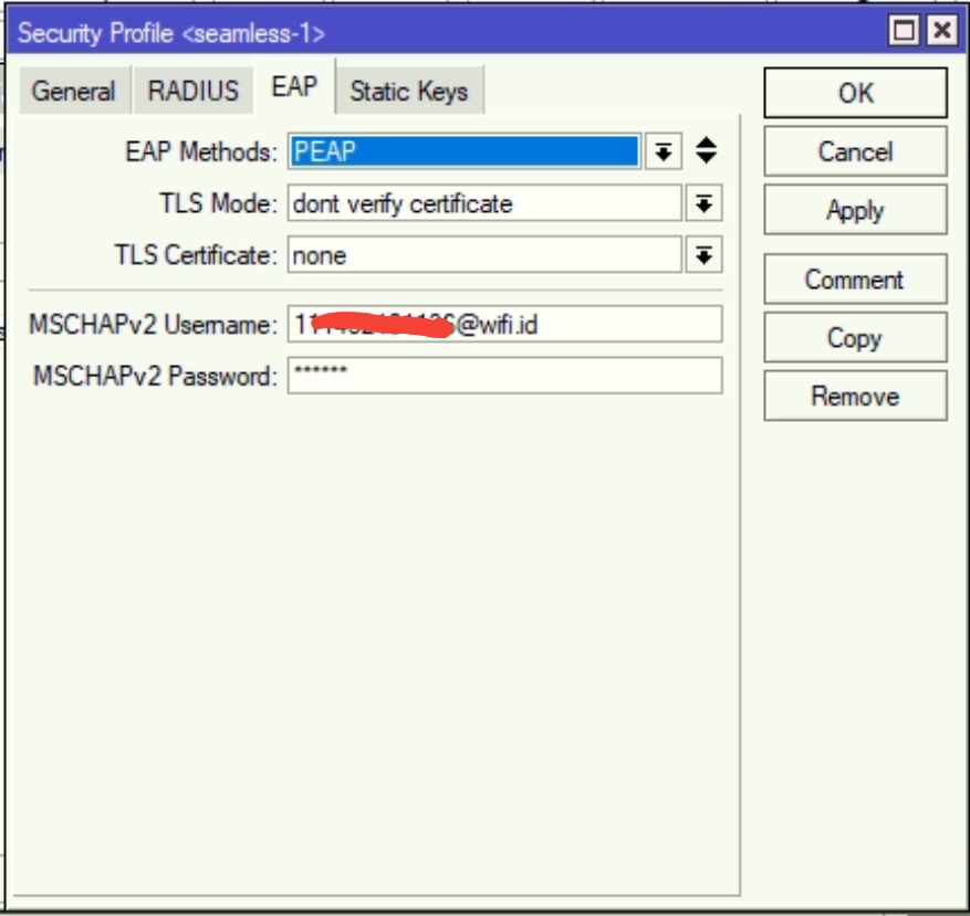

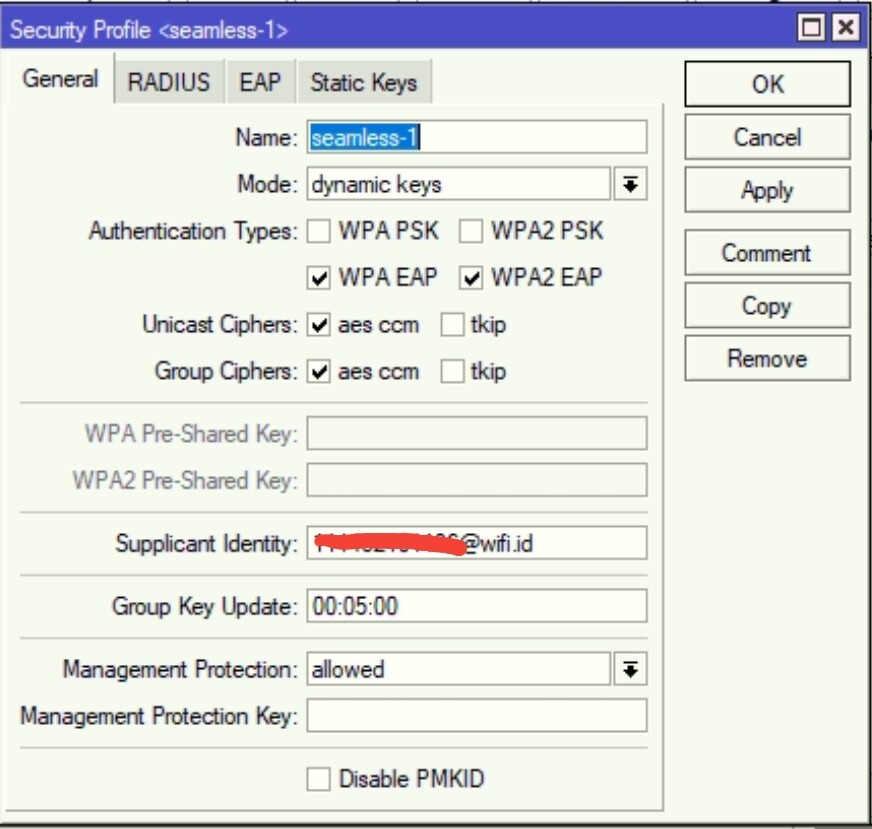

This screen shoot on v6, how i use on v7
FToms
July 18, 2023, 5:19am
15
On hAP ac^2, the settings between v6 and v7 have not changed.
On hAP ax^2, the configuration menu differs from hAP ac^2.
‘mode=dynamic-keys’ is deprecated. The wifiwave2 package only supports authentication with dynamic keys, so there’s no need to set it.
‘mschapv2-password’ is now security.eap-password
‘mschapv2-username’ is security.eap-username parameter
‘supplicant-identity’ is security.eap-anonymous-identity
‘tls-mode’ is security.eap-certificate-mode
‘managagment-protection’ is security.management-protection
If you want more help, please share the output of /interface/wifiwave2/export.

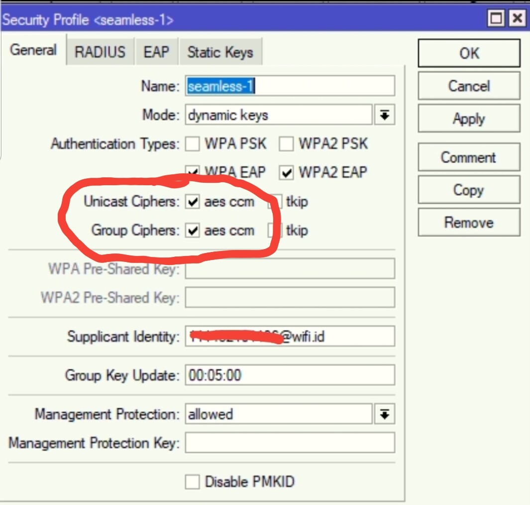

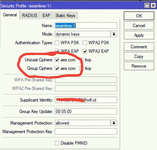

I can not found configuration on AX2 authentication type UNICAST CHIPER & GROUP CIPHERS.
How about it ?
