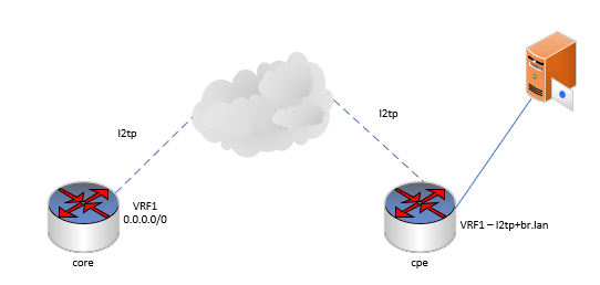

Hi sindy,
the topology is really simple.
The core device is gateway for the my LAN subnet at cpe site.
On that subnet is sitting my server or anything that i can login remotely.
At the moment im doing that by “web-profy”, even with “port forwarding” i will get same result because the ip that im looking for is not in the main routing table.
So i thing i need to do something with tha Mange to leak that ip in to the main table, is that make sense to you?
that is my e.g.
/ip firewall mangle
add action=mark-routing chain=prerouting dst-address=server_ip new-routing-mark=vrf1 passthrough=yes src-address=???
add action=mark-routing chain=prerouting dst-address=??? new-routing-mark=main passthrough=yes routing-mark=vrf1 src-address=server_ip
Where “???” are, im not sure which ip need to be there
Sindy fixed!
/ip route rule
add routing-mark=vrf1 src-address=server_ip table=main
add dst-address=server_ip table=vrf1
i found easy in ip rule.
im wondering how the proper conf would be on Mangle?
