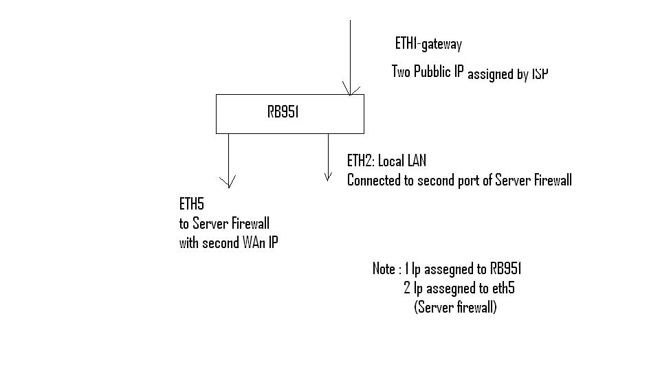

This is the scenario:
I have two Pubblic Address with a same Gw from my ISP:
the first is assegned to LAN connected to my Mikrotik RB951 I implemented by NAt 1-1
the second is assegned to a Server connected on ETH5 through a WAN bridge.
(see the attached setup picture)
The issue was : I can reach the server connected to lan port from Ip assegned to ether1 through the NAt 1-1
