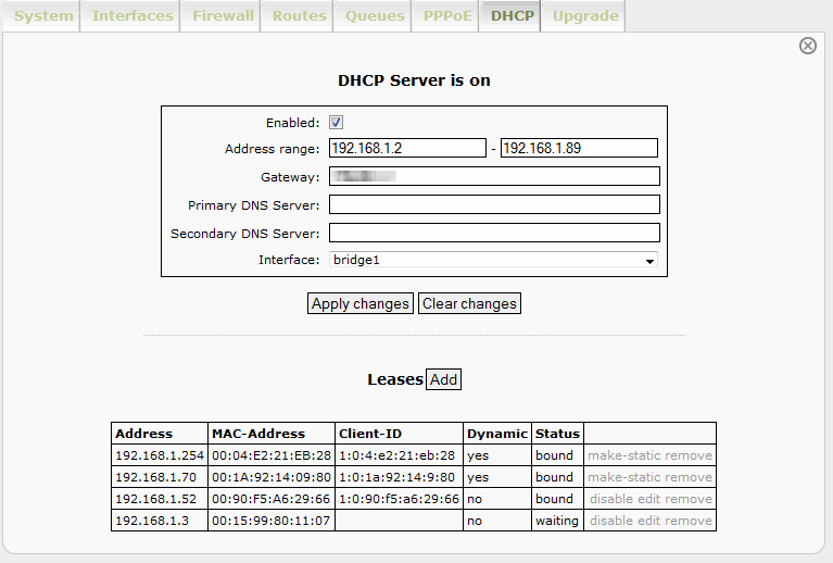

I am trying convert all my settings from my old router to the new one (specifically the Static IP settings).
The issue that I am having is that I don’t really understand the Client ID part of it.
Question 1: How does the Client ID get determined, and can I not manually edit it?
It seems that if it is anything other that what the Router decides it should be it doesn’t actually accept the static setting. (see Client-ID.gif attached)
(I know it is currently blank, but what you see there is what it is no matter what “I” actually put in there)

I sort of figured that the Client ID was not that important, but for some reason that I don’t understand yet if I don’t have it in there, OR, don’t have the one that is created by the router itself, then I can’t assign a static IP to a device defined by it’s MAC. The status just stays as “Waiting” as per the image I have included.
I’ve looked over the link you sent and I don’t see where it is on the page that it addresses the Client ID with regards to what it is I am trying to do. Could you clarify it for me please?
I believe they are Layer 2 but I’ll have to check. They DO accept an IP as assigned by the router, it is just that I can not see it in the routers list of IP’s that have been handed out. That is probably due to my lack of knowledge regarding exactly what Layer 1,2 &3 are and how they work. I’ve seen them mentioned in passing but have not given it much thought until now.
The Switches by netgear have a program you use to access them and to adjust (among other things) the setting the “Static” IP. I just can’t see it in the router when I go look to see if the router gave it to the switch, and therefore I can’t ‘reserve’ that IP for the switch, especially if I don’t know what the Client ID is going to be - - - which ties to my original question regarding the Client ID and not being able to set it and have the status be ‘bound’ as in the image I have sent in the original post.

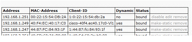

BTW, i have this working.
See the user which No client ID
I do, but the IP is being delivered by the Router Dynamically. Dynamic=yes
Try setting the the IP to an IP of ‘your’ choosing and tell me what happens.

And this is mine:
