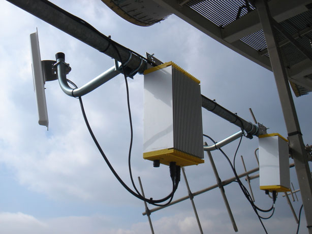

I send you a pic with the antennas situation.

the cases on the second picture seem to be made of some kind of plastic. If that’s true, I would recommend using metal cases well grounded. But with all the other stuff around with probably much higher signal power, I don’t know if a Bandpass filter or some further shielding of cables (and perhaps on Backs of antenna) would help to solve your troubles.
By the way, what are those nice shiny cases on the upper picture? (silver with yellow ends). Seen some of those somewhere before, but couldn’t get information who makes or sells them.

cases are from Lobometrics APs (Lobometrics are x86 and routerboards with ROS installed..). http://www.lobometrics.com. I couldn’t get info about who sells this cases. There isn’t info on it.
We use always metal cases.

Antenna cables could work like small antenna and “catch” signal from other RF- Equipment on your towers disturbing the signal you want to receive. They could be shielded by a “metal hose”, fabric of thin metal wires or similar, connected to case and antenna. Then the unwanted signal would be caught by the outer shield and let to grounding, without getting inside the cable.
Perhaps put a piece of sheet metal on the back of the antenna too, to shield it from signal from the tower?!
