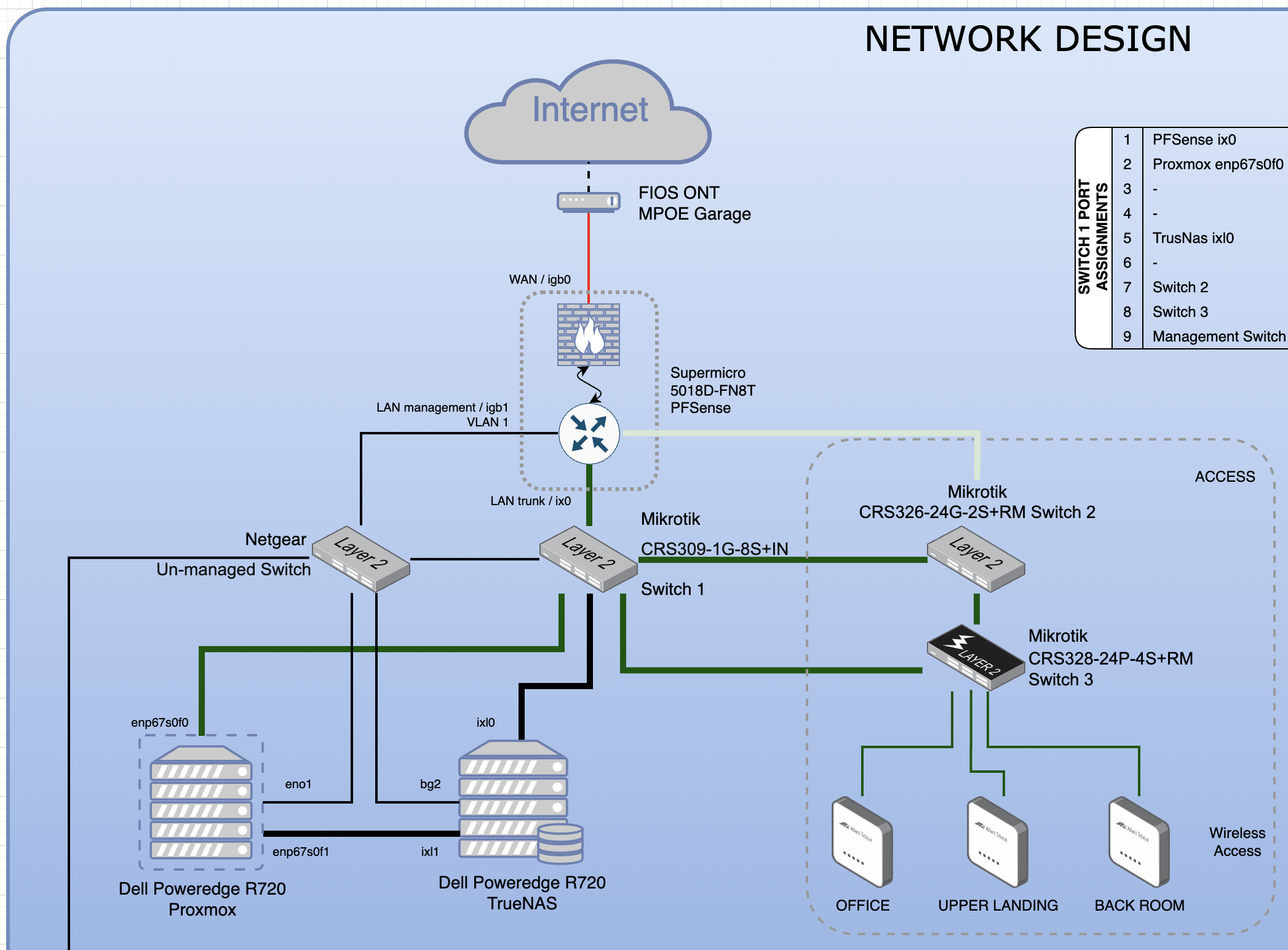

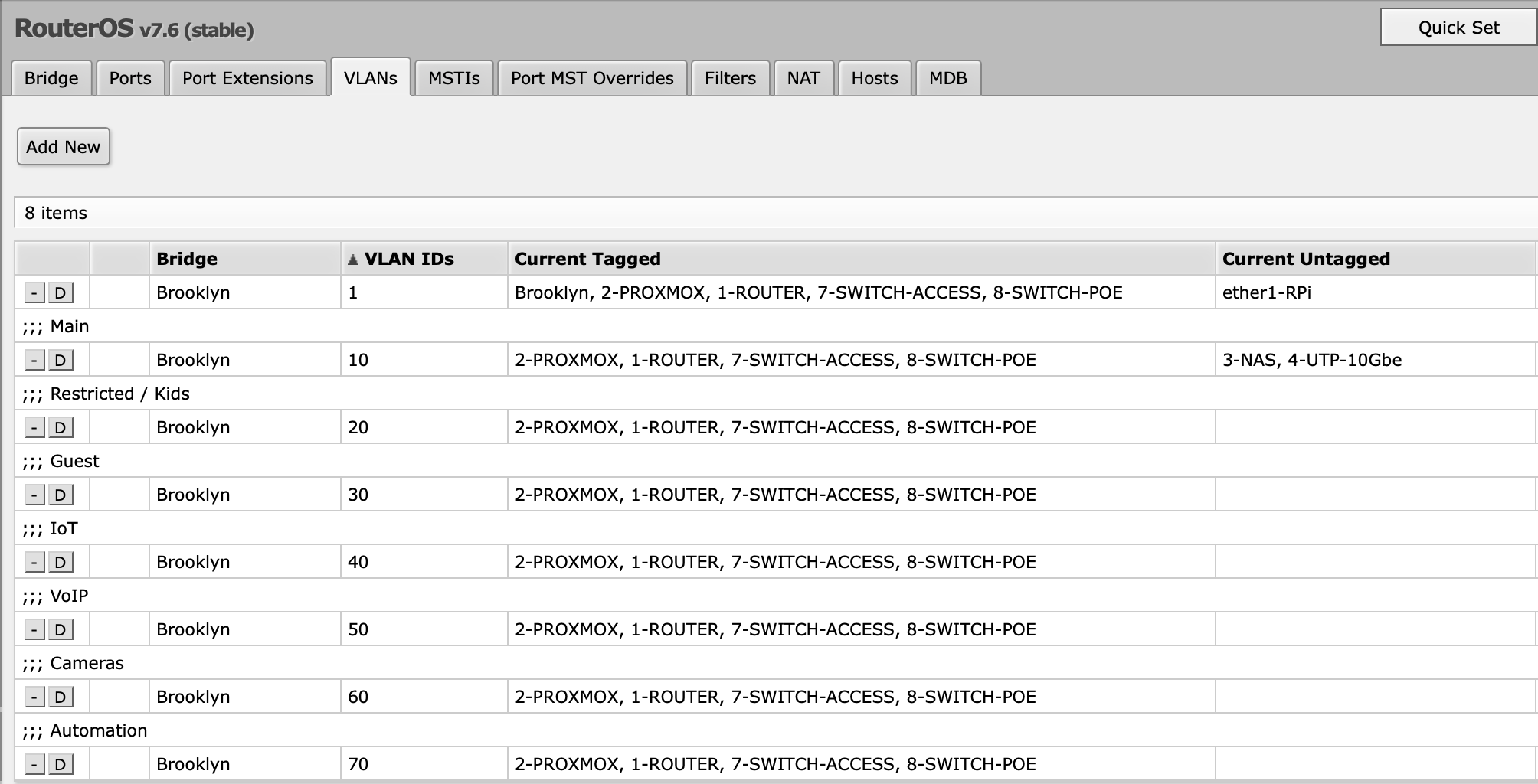

The environment consists of three Mikrotik CRS switches. A network diagram is attached. The CRS309 is my top-of-rack switch for my two servers and pfsense router. The other two CRS switches are for access.
VLANs are routed through the pfsense machine in a router-on-a-stick configuration. No router functions are used in the CRS switches.
The issue I am having is throughput. Using iperf3, traffic between the 10 Gbe hosts never tests greater than 4 Gbps (using the -P 4 option). Usually it is 2.5 Gbps. Additionally, traffic bottlenecks asymmetrically. For example, between my 10 Gbe hosts I will see ~2.5 Gbps in one direction and ~1.8 Gbps in the other. Or, if testing between a 1Gbe host and a 10 Gbe server I will see 940 Mbps up and <800 Mbps down.
For clarity, the throughput issue is on the same VLAN (10) and not routed traffic. The routed traffic is minimal to non-exisitent. Only one bridge exists in the configuration and hardware offload appears to be working. Jumbo frames are NOT being used.
Obviously, there are many variables. But I am not certain my CRS configurations are correct.

first thing i would do is confirm whatever device I am testing from is actually able to create 10Gbps of packets to begin with. Maybe test on a loopbak? or more preferably isolate 2 hosts on 1 switch and test between them
Next I would check my STP settings, you have a lot of duplicate pathways between switches.

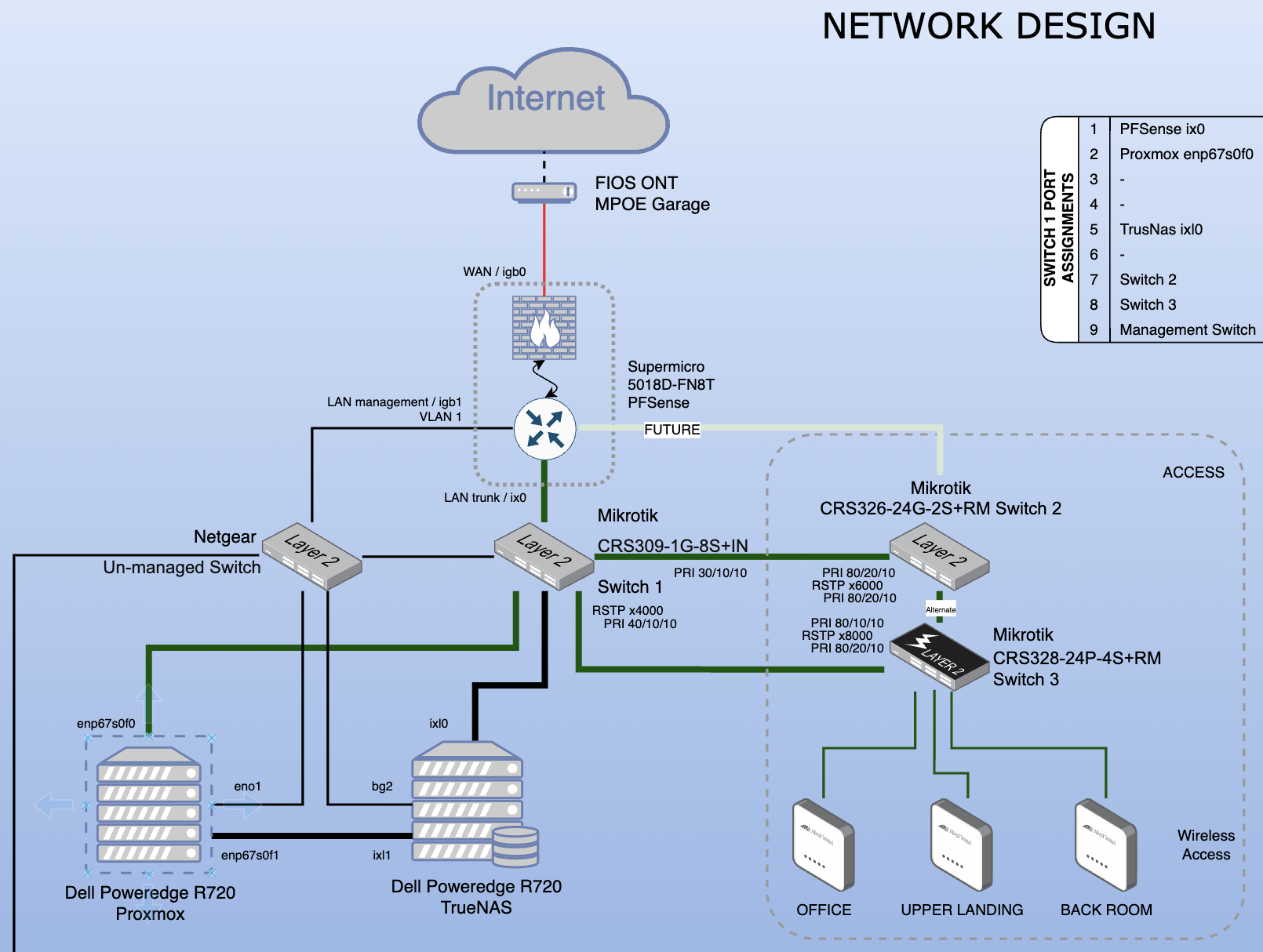

The loop is blocked by RSTP and the NICs appear to be capable of driving a 10 Gbe connection. For the test, I ran iperf3 across the directly attached path between the NAS and Proxmox servers. The test data shows the NAS to Proxmox link handling nearly full wire speed.
Attached are the results of several iperf3 tests. There are numerous retransmits and the congestion window is vanishingly small. When not testing, the network is nearly idle with little to no traffic.
From a Wireshark capture I see several [TCP window specified by the receiver is now completely full] and numerous [Expert Info (Note/Sequence): This frame is a (suspected) retransmission] messages.
Note: I updated the drawing to clarify the details. All test results are from the iperf server output.
Any suggestions on how to track down the cause of the retransmissions?
Thanks again.
