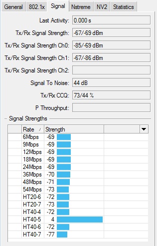

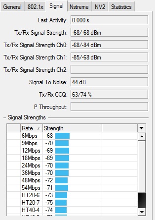

I have a link 5GHz-only N in 4.17 with wireless-test package. I use 20MHz channel with above control activated.
At the ends I have the same hardware: jirous 29D+411AH+R52N.
The registration signals appears like in the images.
As you can see rx/tx is asymmetric and specular in chain0 and chain1.
Consider in 5GHz-A I have -62 and 100% of ccq.
What could this means ? Could be a defective cable ? but in this case must be all the chain with a low signal ?
thanks.
SIDE-A
SIDE-B
