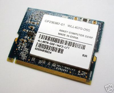

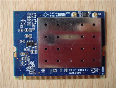

I have 2 different minipci card bought on ebay with atheros 5006x on board
and 2 routerboard 411 with router os 3.9 on board
(in previous version was 3.02 and 3.011)
but routerboard in any case see only 2,4 ghz band (and not 5 ghz band)
in attach there are the pictures of minipci,
they seem to be identical to mikrotik r52 minipci
there is any solution to see 5ghz band on this minipci ?
(if i put it on my pc they are working correctly on 5ghz band)
Stefano
