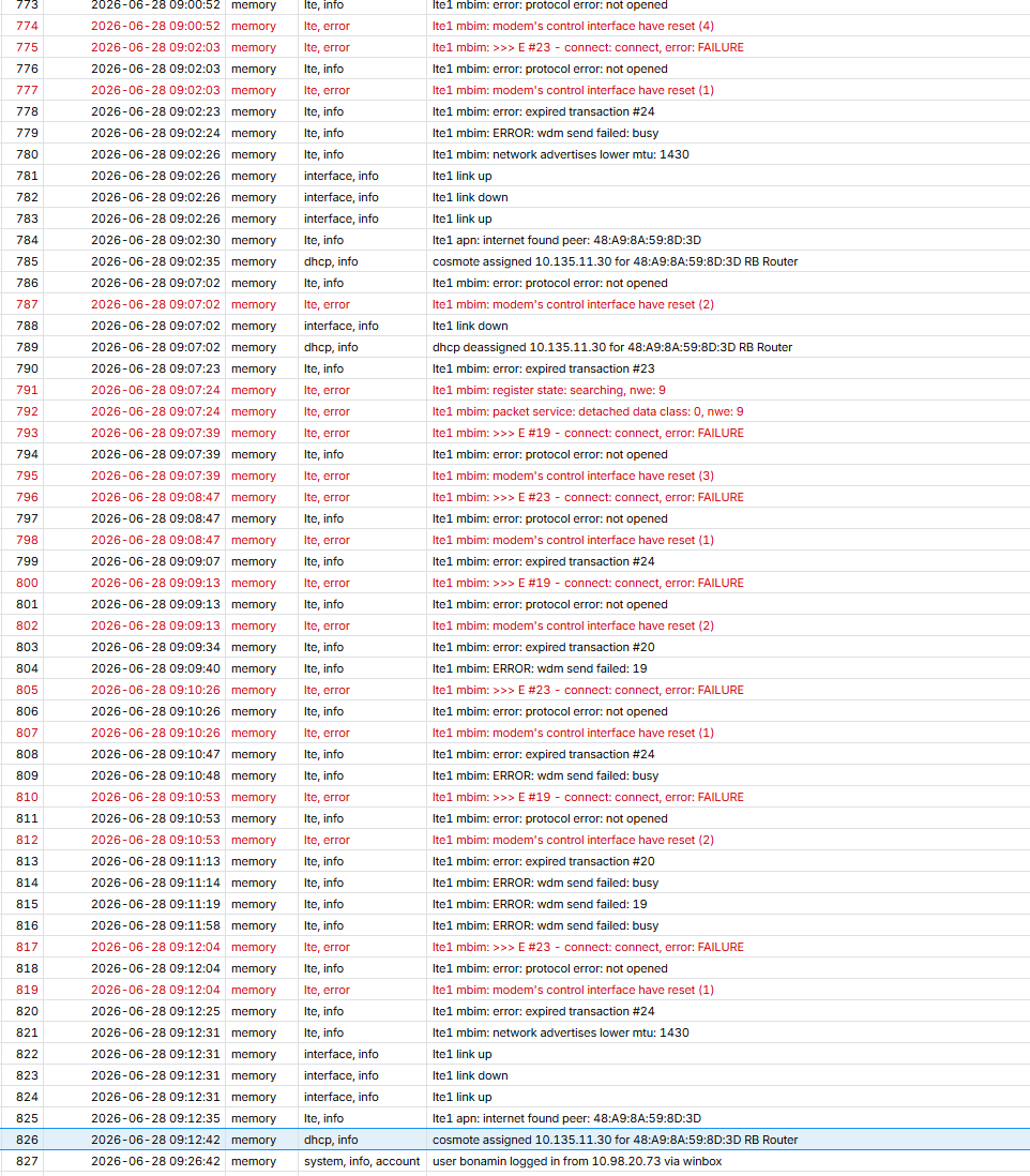

and you can find a few logs from the past couple of days here !

The issue is clearly in the modem/LTE connectivity, but of course there are two ends of it, one the Mikrotik device and the other the ISP.
From your log, besides the connections/disconnections/reconnections there is this line about lower MTU (network advertises lower MTU:1430) that could (or could not) be connected.
Besides the (good) advice to open a support ticket at Mikrotik, I would:
  1. try and fix the MTU issue (sorry, no idea how exactly to torubleshoot that)
  2. experiment what happens if you disable lte and after a small delay (let's say 5-10 seconds) you re-enable it
If the re-connection is always good, without the back and forth re-tries seen in your log extract, then scripting something via scheduler or netwatch to reset the interface could be a temporary workaround.

  1. I set the MTU to 1430 and let's see what happens.
  2. Most of the time, even if I change a setting, I get the same mbim connect errors.
