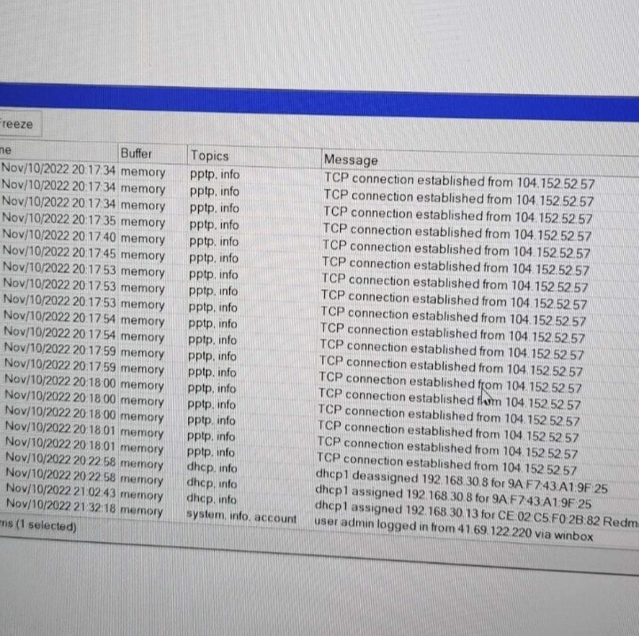

Hello My friends.. so i get this repeated message in my mikrotik RB951ui log as you see below
TCP connection established from 104.152.52.57
so anyone can explain to me what happen here, i make a search to this IP : 104.152.52.54 and i found that this public ip is from a merica.
what i can do in this case
by the way i dont have any pptp tunnel on my mikrotik

The fact that you haven’t configured any PPTP tunnel on your Mikrotik doesn’t mean that PPTP service does not listen for incoming connections.
The log only shows that the unknown address has successfully initiated a TCP session to establish a PPTP control connection, but since it repeats multiple times, it is likely it did not succeed in username&password authentication, which is no surprise given that you haven’t configured any user account for PPTP.
The question is why your firewall permits incoming PPTP connections via WAN - a 951 is a SOHO grade router whose default firewall configuration doesn’t allow any incoming connections via WAN, unless the default configuration comes from a very old version of RouterOS.
