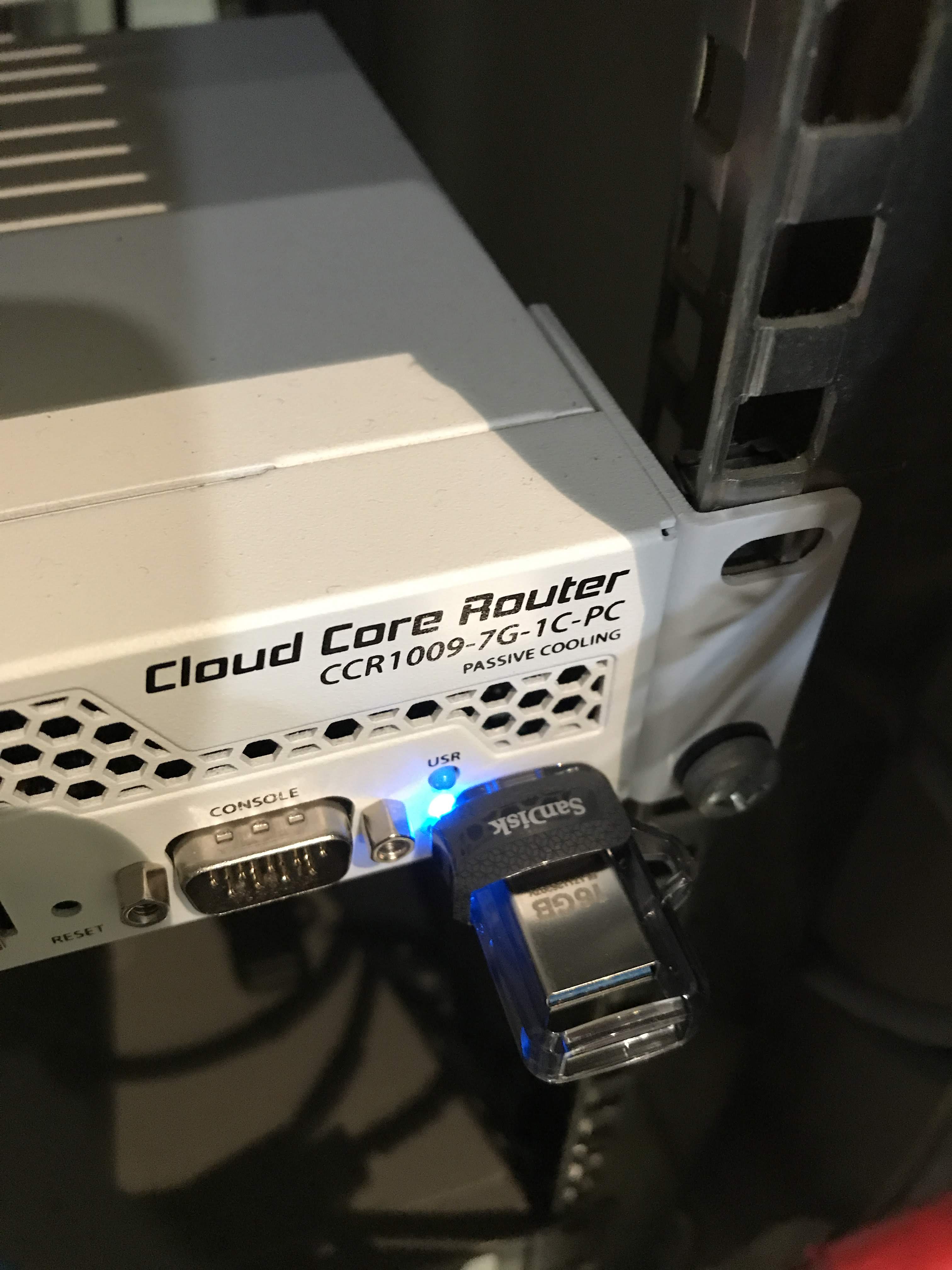

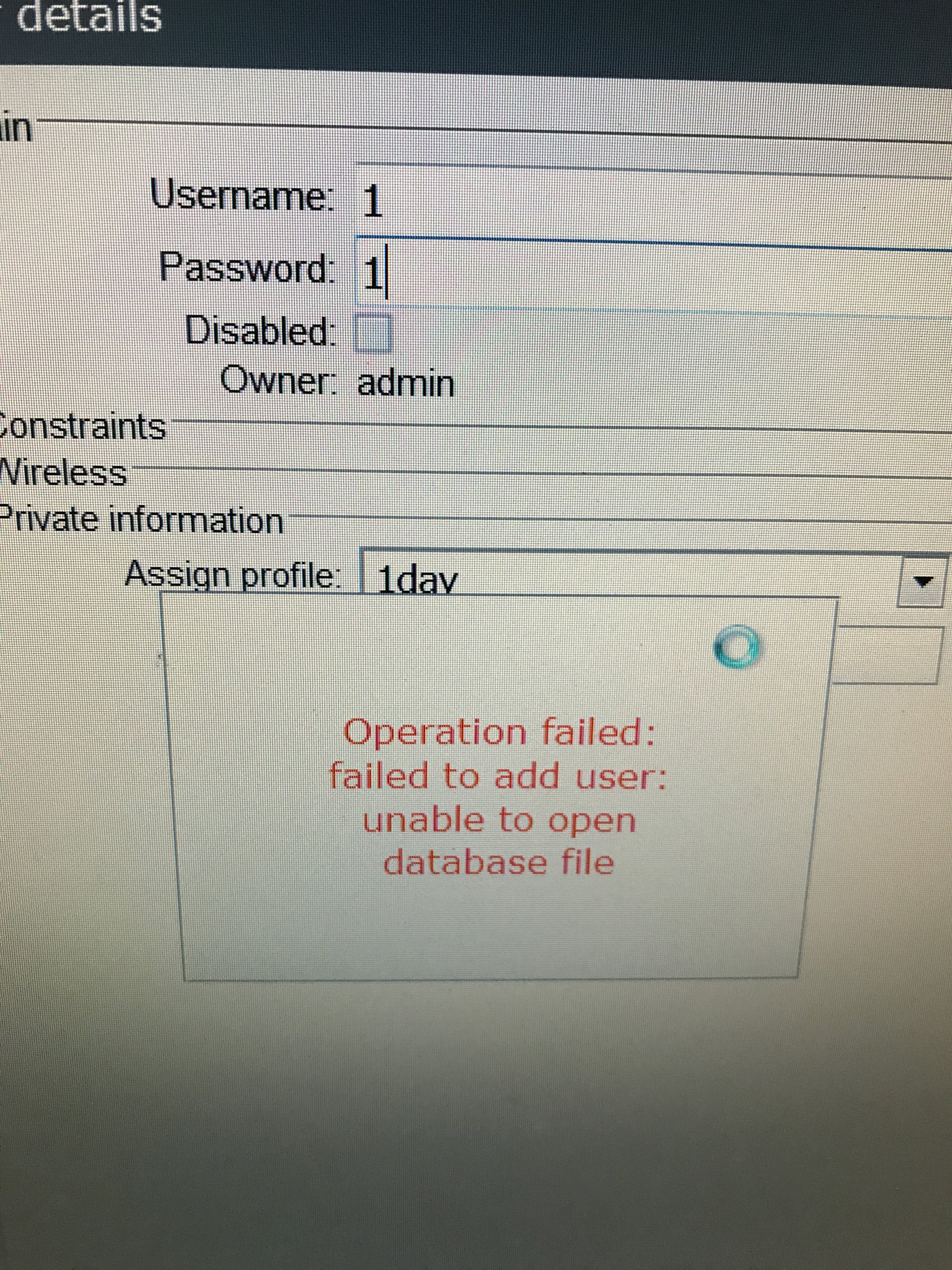

i dont know if its only to my machine but the usb port of CCR1009-7G-1C-PC is very loose if you touch it. 3 times problems with ROS losing/renaming disk name and have problems with user manager.
i was lucky to find it out after three failures of user manager because disk was renamed to DISK5 or DISK6 from DISK4 because someone accidentally soft touch the usb cable extension.

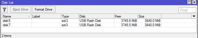

replying to my post logs does not mention anything about changing disk name or removal of disk or added a new disk. IT SHOULD.
just tested it in my lab. this screenshot is after removing usb flash drive and put it back in my rb2011.
i think its better to have a standard usb port than micro usb.
UPDATE: i didnt know that exist usb flash drivers with micro usb plug. i will order one so i get rid off the extension cable.
so i removed the extension cable that the connector side to CCR was loose and installed a micro usb straight to ccr usb port. working flawless!
