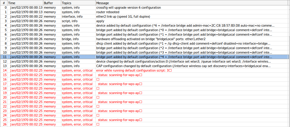

Audience - error while running default configuration script: 3
Sorry in advance if this has already been covered, as I couldn’t find it.
I am trying to get a third Audience AP online and it seems to be having problems loading the default ‘wps-sync-mode-script’. I have reset the device multiple times, upgraded the firmware to 7.12.1, downgraded it to a lower version, and upgraded it back to 7.12.1.
Here are the logs after a reset, holding the WPS button while starting it for 10 secs until the LED flashes amber, and then the sync mode times out after two minutes.
I have opened a support ticket w/ Mikrotik and will post the results here for any future users who might have a similar issue.
