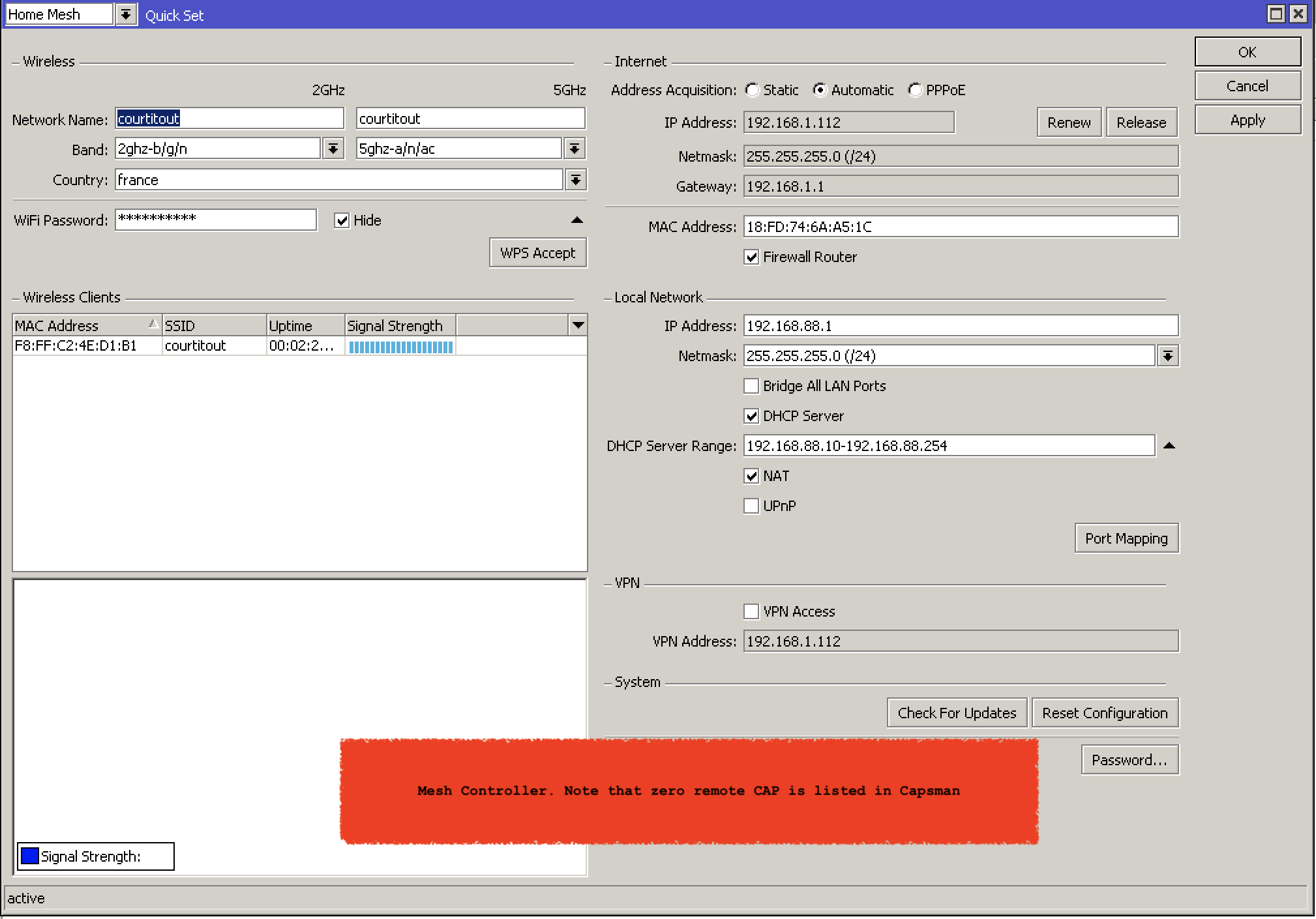

  • The controller unit has a green-not-blinking LED and listens on the 3 wifi channels and its : the 2 user facing channels with the desired SSID and the backhaul channel

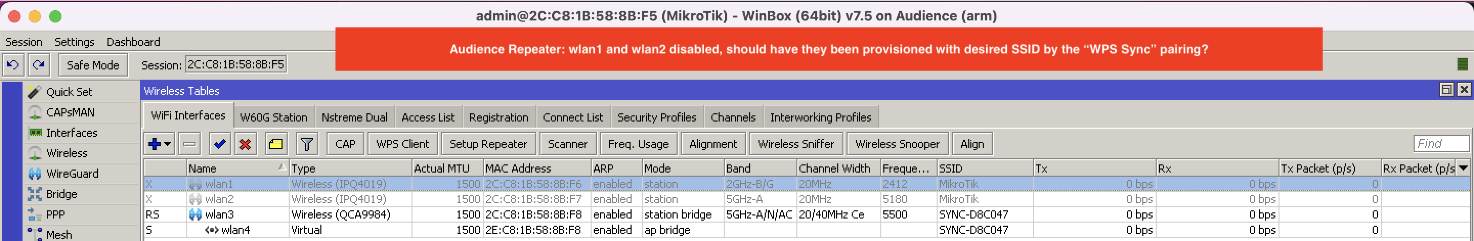

  • The repeater units has a green-not-blinking LED BUT only listen on the backhaul wifi channel (SSID “SYNC-***”) , they don’t listen on the user facing wifi channels
Further investigation using Winbox showed me that:
  • Repeater units
  • Are connectable with Winbox on their Mac address on ETH2 with the default login/password but they don’t have an IP address
    • Have wlan1 and wlan2 disabled / greyed
    • Have wlan3 enabled (the backhaul channel) in mode Station Bridge and Winbox reports a virtual wlan4 in mode AP Bridge (I don’t know what a virtual wireless interface is, I’m not very knowledgeable on networking)

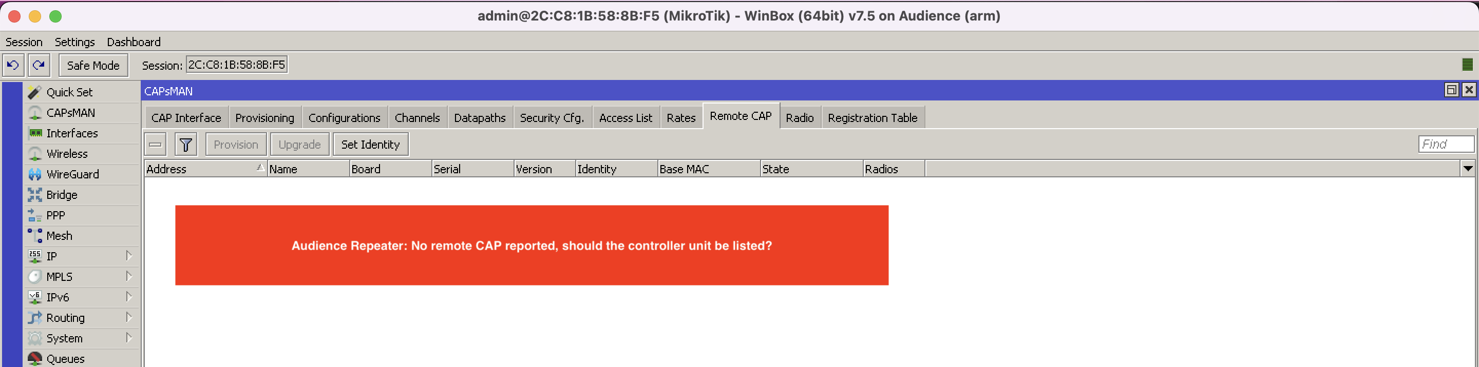

    • Don’t report any “Remote CAP” in the CapsMan screens

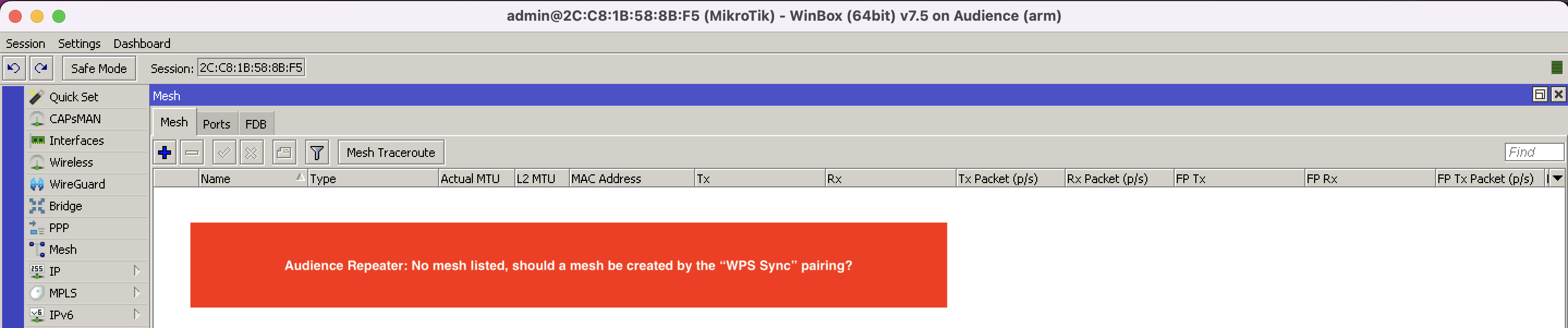

    • Don’t report a Mesh configured
