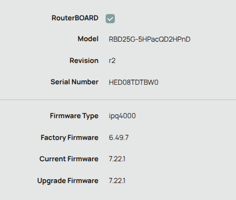

Audience Tri-band AP. Can I, Should I, Switch qcom Drivers
Hardware is:

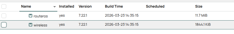

The wifi package - wifi-qcom- is not listed, only the RouterOS and wireless packages. So I’m not even sure if the upgrade is possible

Execute the usual "check for updates" as you would do for ROS update. It also refreshes the package list. You'll the see all other packages - inactive - as well. Uninstall wireless, install wifi-qcom-ac and confirm reboot. Be aware, your wireless config is not migrated. You need to configure wifi from scratch.
Thanks to all who replied. After stumbling around for a few hours I accidentally followed infabo’s instructions and got wifi working with wifi-qcom-ac.
