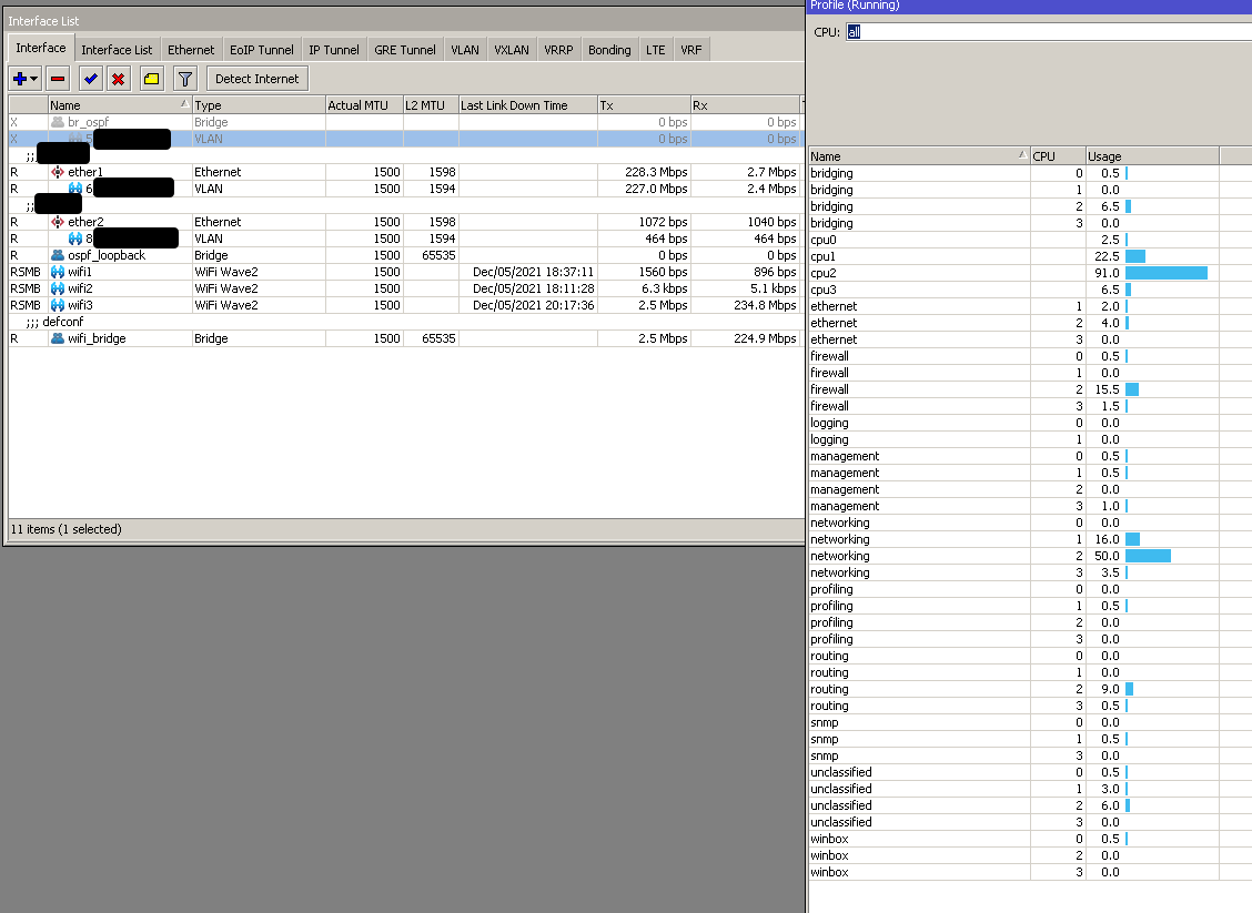

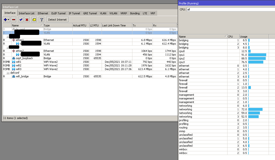

After running profile I can see that during download CPU load is distributed between CPUs, while during upload - 1 CPU is maxed out.
Download:
Upload:
