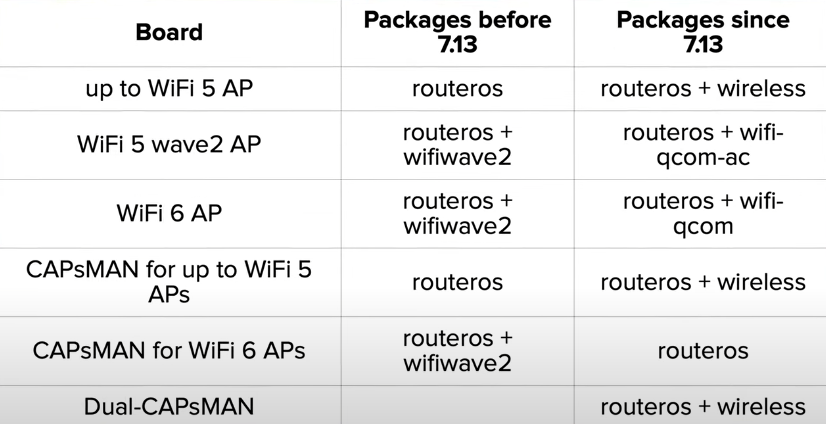

I don’t understand, you do not need any wifi-qcom package on your CAPsMAN device, if you are trying to run new wifi 7.13+ CAPsMAN you totally can even on a device without wifi-qcom(ac) drivers, you do not even need a device with wireless radios, because since 7.13 CAPsMAN is embedded in the routeros package itself.
So go ahead, install wifi-qcom-ac on your audiences, then go to Wifi menu on your CCR2004 and configure CAPsMAN there.
That’s not what I’m seeing within the CCR2004. It’s also not what I see in MikroTik’s own guide (attached.) The new CAPsMAN (WiFi menu) is reserved for WiFi 6 devices. The Audience is not WiFi 6. I’ve also tested it and can confirm, the Audience(s) do not appear in the new CAPsMAN for adoption/provisioning. They only appear in the old CAPsMAN (Wireless → CAPsMAN) manager.
Truth is I only manage ax devices through the CAPsMAN Wifi menu (it works even on RB2011), but I have seen many tutorials where even ac devices were managed by the new capsan successfully, so I do not understand that table from Mikrotik. I was under the impression the new Wifi CAPsMAN works with all devices that support wifi-qcom(ac) drivers.
