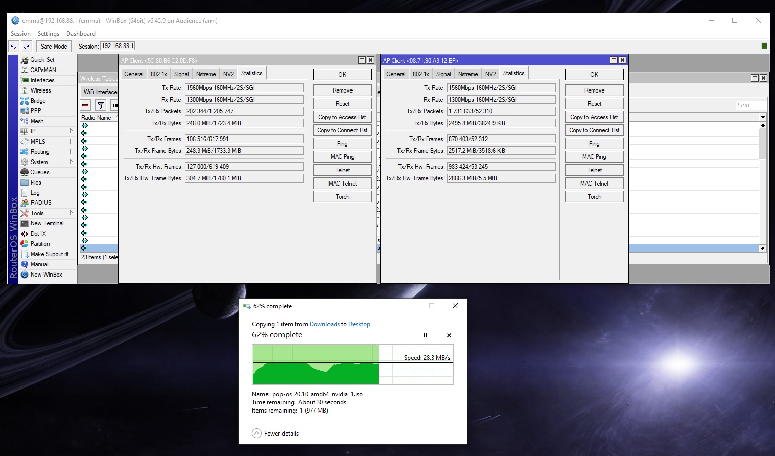

My setup: Audience running 6.45.9 on which I have connected, to the 3rd wlan, a laptop with an Intel AX200 wifi card (A) and a small PC running an Intel AC9560 wifi card (B). Wlan3 is setup with a channel width of 160MHz and both devices are connected as such to it - see the screen capture taken with both devices in the same room with router, aprox 1.5m from it, in direct linesight (roughly positioned in a triangle shape).
Both A&B, downloading from my OpenMediaVault server connecting via cable, reach ~80MB/s
Both A&B have latest drivers since I’ve read that at least AX Intel drivers should be kept up-to-date.
A downloading from B or B downloading from A - in either case the speed is ~30MB/s ← is this the best to expect while on wireless?

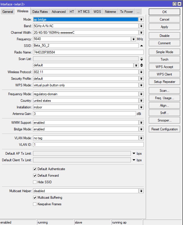

try with keepalive frames=enabled
I had that option ON but I noticed that, with it OFF, mobile phones have a better battery life.
Gave it a try with that option enabled.. again, it maxes out @ ~30 MB/s

Agreed! And I installed 6.46.8 this morning, I also fiddled a bit with the settings: switched from country US to country RO, also changed the channel to 5500 Ceeeeeee - no changes. Defaulted the data rates - no change. Won’t get over 30 MB/s..
30MB/s is pretty normal for MT wifi, there is nothing to do with the setting, keep alive frame?? what the… it will only drain your devices battery by keep sending frame every second, Wi-Fi 6 even introduce a technology called “TWT” to save battery life but here we do the other way round?? MT wifi slow is due to driver, not setting, no magic setting here at all. Accept the speed or change to another vendor, there are a very famous says “why do you need such high speed for wireless devices??”, lol
The only way to improve speed is to play with the data rates, basic rates 12/24mbps and supported rates 12~54mbps, other settings seems fancy but do nothing with the speed, forget about it.
Oh well, 30 MB/s it is then.. I tried with default data rates, now I’m back @ 12/24 and 12-54. I gave a try to “keep alive frames” but speed was the same and mobile phones lost a lot of battery.
